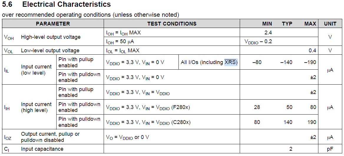

I am using TMS320F2808 IC in one of our projects I would like to know the internal pullup resistor value at pin number 78(XRS).
With regards,
Sivakrishna
  • The internal pull up isn't a true resistor. It can be thought of as an 'active circuit' or a current source, with the rating being held in the electrical characteristics table show below. this information was take from the datasheet.
