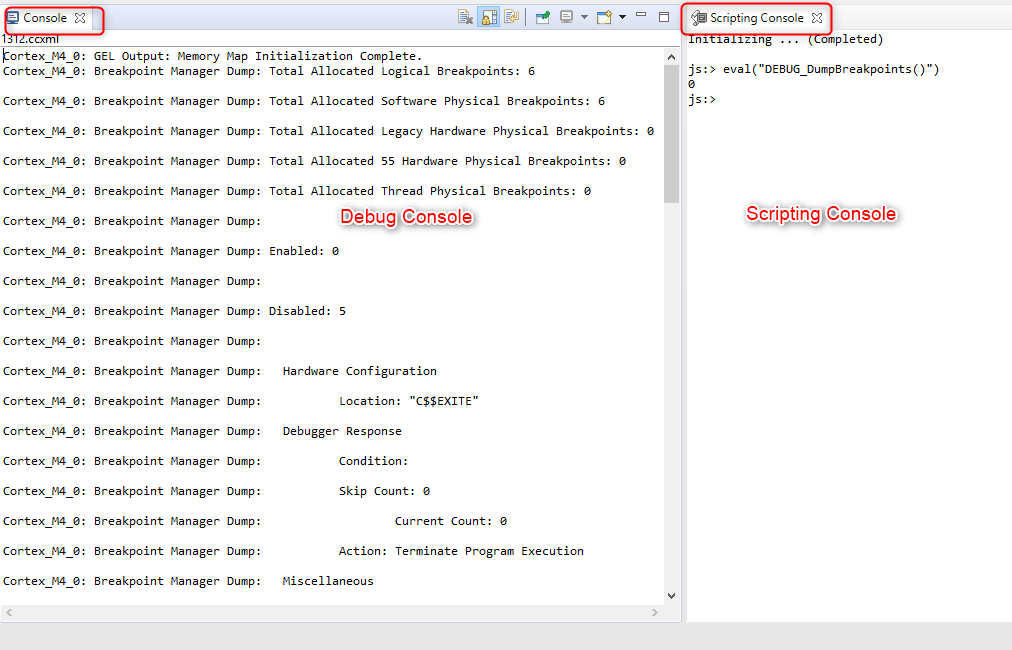

  • Hi Nagesh,
    Can you make sure the Breakpoints view is clear and then run the following command from the Scripting Console:
    eval("DEBUG_DumpBreakpoints()")
    And then copy and paste the output in the Debug Console to a text file and attach the file to this thread.
    ki
  • hi Ki,
    I did as per your instructions, everytime i execute the output of above command is '0' either i select the breakpoints or not. below is the screen shot what i observed.
    thanks,
    Nagesh
    That would be the output of the Scripting Console. What I am interested in is the output in the Debug Console.

    C28xx_CPU1: Breakpoint Manager Dump: 	Debugger Response
    C28xx_CPU1: Breakpoint Manager Dump: 		Condition:
    C28xx_CPU1: Breakpoint Manager Dump: 		Skip Count: 0
    C28xx_CPU1: Breakpoint Manager Dump: 			Current Count: 0
    C28xx_CPU1: Breakpoint Manager Dump: 		Action: Remain Halted
    C28xx_CPU1: Breakpoint Manager Dump: 	Miscellaneous
    C28xx_CPU1: Breakpoint Manager Dump: 		Group: Default Group
    C28xx_CPU1: Breakpoint Manager Dump: 		Name: Breakpoint
    C28xx_CPU1: Breakpoint Manager Dump: 	Breakpoint set by the user
    C28xx_CPU1: Breakpoint Manager Dump: 	Hardware Configuration
    C28xx_CPU1: Breakpoint Manager Dump: 		Location: "C$$IO$$"
    C28xx_CPU1: Breakpoint Manager Dump: 		Action: Process CIO
    C28xx_CPU1: Breakpoint Manager Dump: 	Breakpoint set by the system
    C28xx_CPU1: Breakpoint Manager Dump: 		Location: "C$$IOE$$"
    C28xx_CPU1: Breakpoint Manager Dump: 		Location: "C$$EXITE"
    C28xx_CPU1: Breakpoint Manager Dump: 		Action: Terminate Program Execution
    C28xx_CPU1: Breakpoint Manager Dump: 		Type: Breakpoint
    C28xx_CPU1: Breakpoint Manager Dump: 			Location: C:\Users\E537053\F28388D\GBL_V2_F28388D\Debug/../main.c, line 231 ("C:\Users\E537053\F28388D\GBL_V2_F28388D\Debug\GBL_V2_F28388D.out") (0x80b79)
    C28xx_CPU1: Breakpoint Manager Dump: 			Location Mask: 0
    C28xx_CPU1: Breakpoint Manager Dump: 			Compare Mode: None
    C28xx_CPU1: Breakpoint Manager Dump: 			Action Type:
    C28xx_CPU1: Breakpoint Manager Dump: 				Halt CPU: true
    C28xx_CPU1: Breakpoint Manager Dump: 				Drive EMU Pin: false
    C28xx_CPU1: Breakpoint Manager Dump: 				RTOS Interrupt: false
    C28xx_CPU1: Breakpoint Manager Dump: 			Location: "C$$EXIT" (0x820d6)
