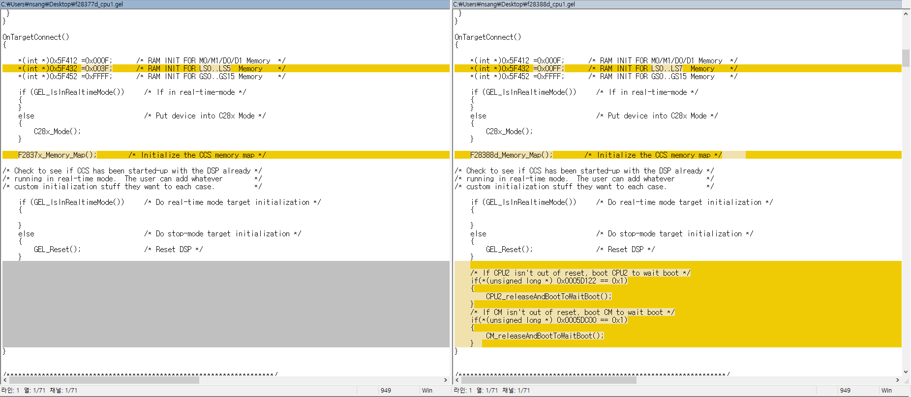

  • Additionally, The error I mentioned above occurs in TMS320F28377D, but not in TMS320F28388D.
    If you compare the f28377d_cpu1.gel and f28388d_cpu1.gel, there are differences like the attached image, and I wonder if it is related to this problem.
    (In the case of the f28377d_cpu1.gel file, the process for CPU2 is not included when connecting or resetting the chip.)
    I don't see any issue in Gel file. The difference you are seeing is because of some hardware changes/enhancement on F28388 device. We as well as many customers are using same Gel file with out any issue.
