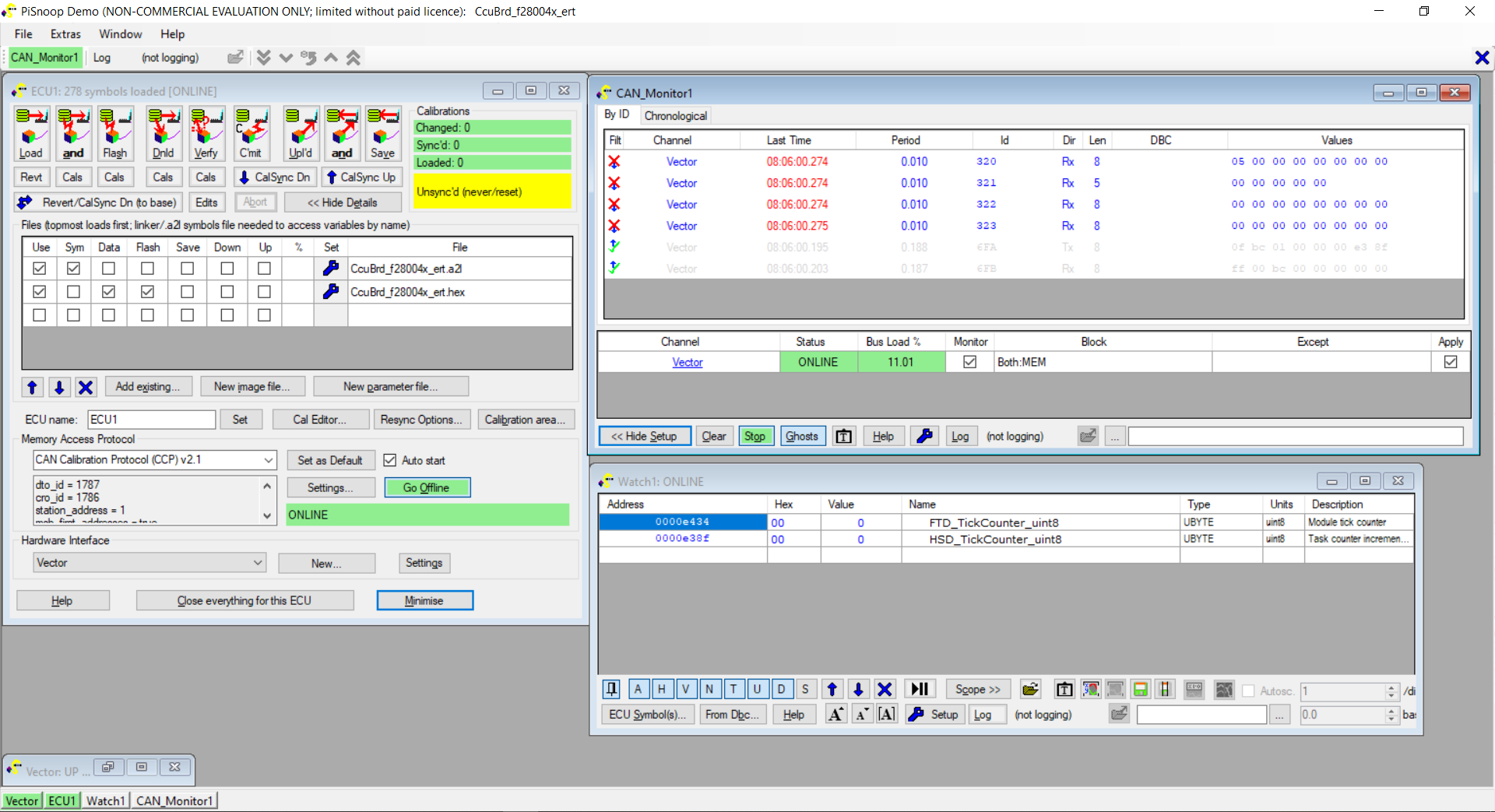

My code builds fine and then the tool I have (at the moment) to test this is Pi Snoop (from Pi Innovo) which is a trial but I already informed myself with them and it should still allow me to monitor signals.
I can establish comms and see the DTO which is being sent by the chip "0x6FB" (the CCP IDs are greyed out in this software but it's just for displaying purposes, this is cyclically updating):
In my model I've defined the signals as canlib.Signal with storage class Daq_List_Signal_Processing and the parameters as tic2000demospkg.Parameter  with storage class const_data_ramfuncs just as the example available "c28x_ccp_ert" but I'm using sldd data.
I can see the command on 0x6FA flickering between CONNECT (0x01), SHORT_UP (0x0F) and GET_S_STATUS(0x0D) but 0x6FB always replies "acknowledge / no error" (0xFF) with no error code (byte 1) and a (matching 0x6FA) rolling counter on byte 2.
My A2L has all the addresses defined correctly and the tool sees the correct addresses but can't somehow get an answer from the chip. I'm not sure if it's the tool or if I'm doing something wrong but I also cannot do CCP comms with the example code "c28x_ccp_ert", the behaviour is exactly the same.
I'm using eCAN A and tried both 500kbps and 1MBps just for the sake of it and neither worked, the behaviour is identical.

    In the meanwhile I have managed to make it work and it was a tool problem, I can use it with CANape which was the only one validated by mathworks:
    uk.mathworks.com/.../c28xcancalibrationprotocol.html
    Just as an FYI I'm using now canlib.Signal and canlib.Parameter, both with ExternalGlobal storage class and this works fine.

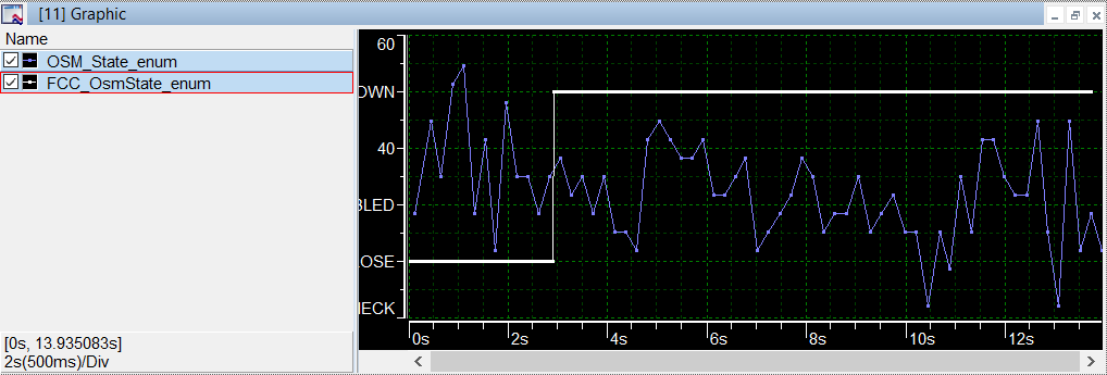

    My only issue at the moment (or at least that I can see) is that my enumerations are going crazy, somehow they are moving, while polled via CCP but static via CAN (since I'm outputting it on the CAN bus)
    I can see this is only happening to my SLONG signals:
    /begin MEASUREMENT
    /* Name */ OSM_State_enum
    /* Long identifier */ "Module state machine state"
    /* Data type */ SLONG
    /* Conversion method */ CcuBrd_f28004x_ert_CM_OSM_STATE_ENUM_enum
    /* Resolution (Not used) */ 0
    /* Accuracy (Not used) */ 0
    /* Lower limit */ 5
    /* Upper limit */ 80
    ECU_ADDRESS 0x0000c781
    /end MEASUREMENT
