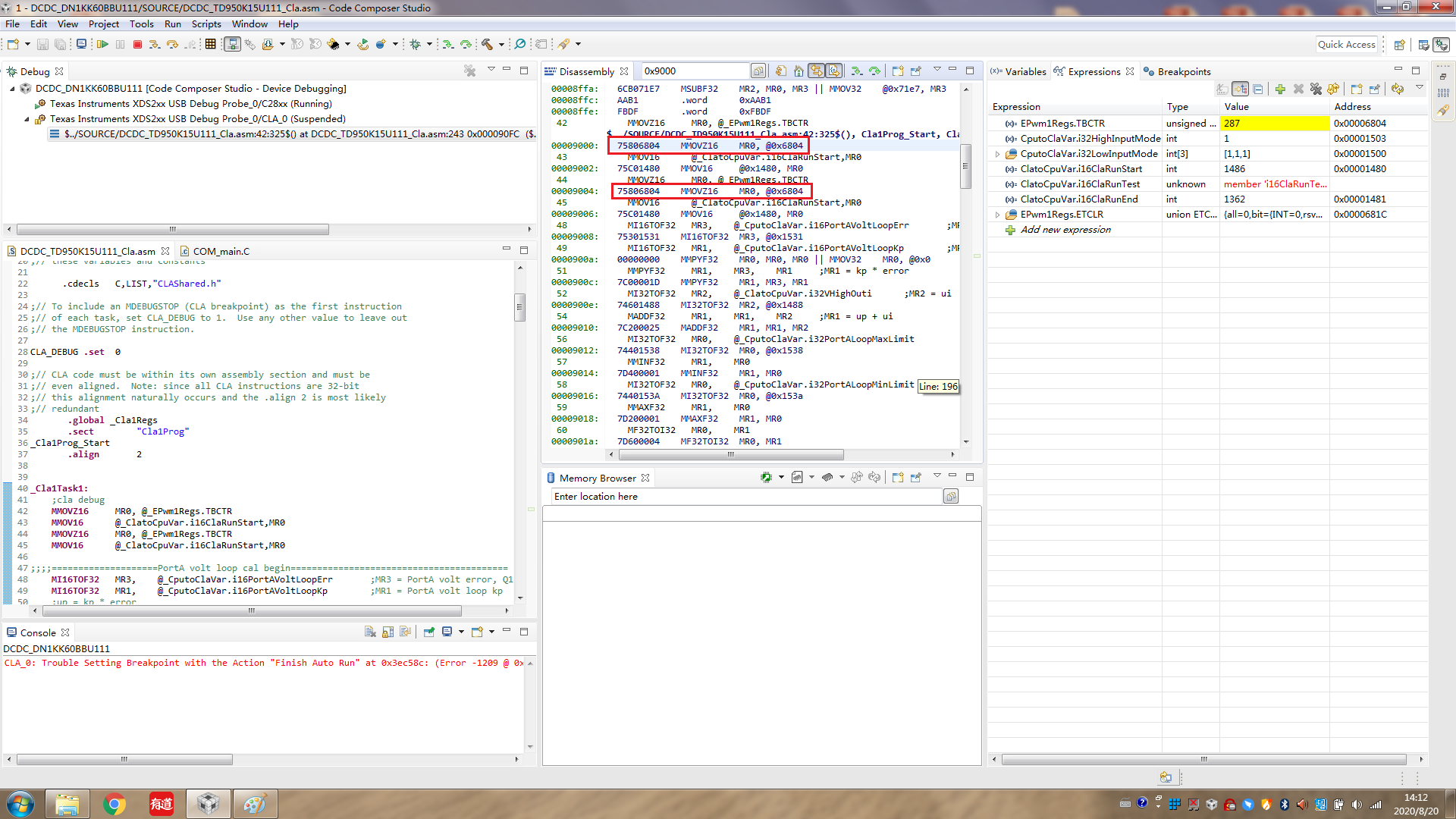

  • Q1: "ClaTask1 does not have contain frame information", what 's mean of this display?
  • Q3 is almost same as Q2,  the address of CputoClaVar.i32HighInputMode  is 0x1503, the value is 1, but in Disassembly, read the value of 0x1506 the compare with MR0(0x02).
    Need suggestion,thanks.

  • Tobby,  Can you attach the .map file for me to look at?  Thank you.
    Lori
    This is normal.  The Cla1Task is an entry point so there is no stack to unwind.
    Lori

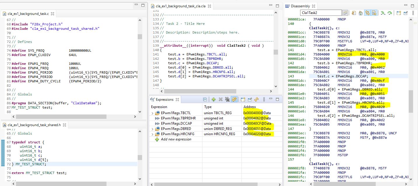

  • Q3 ls related to data type define ,I change int16 to int16_t, the variable address is correct.
  • Check the map file, I think the address of EpwmRegsfile is normal.
    Then compare my project with example project in C2000ware,
    The address of EPwmRegs in two project in Expressions is identical.
    Q1, In Disassembly, in my project, 32-bit instruction to read register value, but in C2000ware project, 16-bit instruction to read same register value. I think this difference lead to incorrect register address in my project.
    Q2, More MNOP instruction in my project, this two project have same configure on the opt_level and opt_for_speed .
    Need your suggestion, Thanks.
    Are you including the file DSP2803x_Cla_typedefs.h for the CLA code?  In our older examples instead of using C99 datatypes we used this file to describe the size of variables to the compiler.   You should see this include in the C2000ware examples as well.
  • Lori,
    I miss  DSP2803x_Cla_typedefs.h in my project.
    I add this header file, nothing change in the CLA Disassemble Code.
  • First, add #include "DSP2803x_Cla_typedefs.h" to first line of CLA file. In Disassembly, 16-bit Register variable is still read use 32-bit instruction.
  • The linked define of Uint16 in my project
    Need more suggestion, Thanks.
  • Tobby,
    I took an example from C2000Ware - the acos example, and added the following lines to try and reproduce the issue. These are the only lines I added - all of the #includes are as I found them.
    __interrupt void Cla1Task2 ( void )
        Uint16 temp;
        temp = EPwm1Regs.TBCTR;
    I don't have a 2803x with me, so I added the option to keep the assembly so I could view it.  I see a MOVZ16 is being used to read the ePWM register:
    _Cla1Task2:
    	.dwpsn	file "../acos.cla",line 132,column 5,is_stmt,isa 0
            MMOVZ16   MR0,@_EPwm1Regs+4     ; [CPU_FPU] |132|

    I've been trying to reproduce the issue but have not been able to.   Note: Because I do not have a F2803x with me (I am working from home due to COVID) I tried this on a F28004x.  The same would apply to your device except the PWM registers are at a different memory address.  The disassembly instructions match the expressions window regarding the address.
    I have detailed my steps below.  If this does not help resolve the problem, please work with Brian Wang to send me a small test case that reproduces the issue?
    1) Created a structure, similar to yours, as shown.  This goes in the shared.h header file:
    typedef struct {
        uint16_t a;
        uint16_t b;
        uint16_t c;
        uint16_t d[5];
    } MY_TEST_STRUCT;
    extern MY_TEST_STRUCT test;
    2) In the main C28x .c file define the structure as shown:
    // Included Files
    #include "F28x_Project.h"
    #include "shared.h"
    #pragma DATA_SECTION(buffer, "Cla1DataRam");
    3) In the CLA .cla file:
    #include <stdint.h>
    #include "f28004x_device.h"
    #include "shared.h"
    __attribute__((interrupt))  void Cla1Task2 ( void )
        test.a = EPwm1Regs.TBCTL.all;
        test.b = EPwm1Regs.TBPRDHR;
        test.c = EPwm1Regs.DCCAP;
        test.d[0] = EPwm1Regs.DBRED.all;
        test.d[1] = EPwm1Regs.HRCNFG.all;
        test.d[2] = EPwm1Regs.DCAHTRIPSEL.all;
    4) Observe disassembly and Expressions window match addresses.  Note: 28004x has different memory locations for the ePWM registers than the F2803x you are using.
  • Lori,
    Thanks for you suggestion.
    In original project, use assemble to write CLA code, now we want use C,
    In debug Cla code, find the register address is incorrect.
    Same project, the Register address in CAL is right in assemble, wrong in C code .
    The screenshot is below, Need more suggestion, Thanks.
  • Use assemble to write CLA code, the address in Disassembly is right.
  • Use C to write CLA code, the address in Disassembly is incorrect

  • Lori,
    Thanks for your suggestion.
    Exclude  #include "DSP280x_Device.h" in CLA C source code, only #include "CLAShared.h" &&  #include "DSP2803x_EPwm.h" , the Epwm Register address in disassembly is correct.
    CLAShared.h include the variables used in CLA C code, define by me.
    I compare my DSP280x_Device.h with file in  C2000ware,  can not find what lead the Register address in Disassembly incorrect.
  • Register address in Disassembly is incorrect on left side code, correct on right side code
