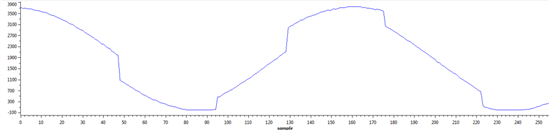

First off, I get the feeling that the highest sample rate, 4.6Msps, might be very optimistic. When I've tried to do continuous sampling, even at lower sampling rates, I get problems that seems to be that I cant manage to process the adc results before next interrupt occurs. Sampling at 4.6 Msps seems to be a very big challenge if I have trouble sampling at 850ksps. Is it even theoretically possible to sample that fast with a 28027 running at 60 MHz? And if not, what can be the highest achievable sample rate?
Back to my problem.
As you can see in the attached code I use all SOCs, and they are triggered by ADCINT1. ADCINT1 is triggered by EOC14. In the ContinousAdc-example EOC14 triggers ADCINT1, so I did that too. With INT1CONT set and the round-robin principle I suppose ADCIN1 should be sampled at a periodic rate?
This is a graph of my buffer (currently 256 bytes, theres a 4KHz sine on ADCIN1):
The reason for using all SOCs was basically that it might be possible to copy the ADC result in the interrupt without stalling the next ADC interrupt while doing so. Im not sure if this is the way to do it though. Any suggestions?

  • Time for an update.
    After some serious doubts about the processor and/or my own competence I figured out the problem. The ISR, adc_isr above, executed from The fact that the default wait state settings for the flash are 15 clks and that the flash pipeline is turned off by default didnt help that much for the speed either.
    Adding the following line made all the difference:
    #pragma CODE_SECTION(adc_isr, "ramfuncs");
    And then copy it to the RAM solved my issue.
