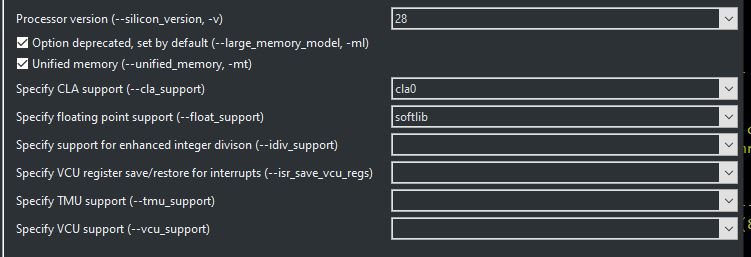

  • I have copied/integrate the demo code in Resolver_f28035_CLA from TMDSRSLVR_v1.0 into my based code with F28069M device
    I have read the Resolver_sw_library.pdf and noted the F28069M use float than fixed, so I copied over the Resolver_Lib_CLA_float.lib into local folder with include setup for compiler and linker.
    I get this compiler error and warning.
    I note there no demo code for F28069_CLA due to difference in FLOAT and FIXED as in F28035_CLA, I'm not sure what to change in Resolver_Cla.h
    I can send this code via private file. I'm kinda stuck there for F28069M.

  • CLA supports floating point on all C2000 devices. The difference on FPU support is only in C28x CPU.
    Please check if you have enabled CLA and FPU support in Processor Options tab in your project properties setting.
    For more help on debugging the code, you will need to share the project file with us. You can reach out to your TI local support team on sharing the code if you are not willing to share it in public forum. Thanks.

    For floating point support, please try to select FPU32 instead.

  • CCS_Setup.docx
    Resent in word document, the previous post paste picture did not work.
    Can you send me complier/linker error so I can help to fix it. You can use riscy00 at gmail dot com.
