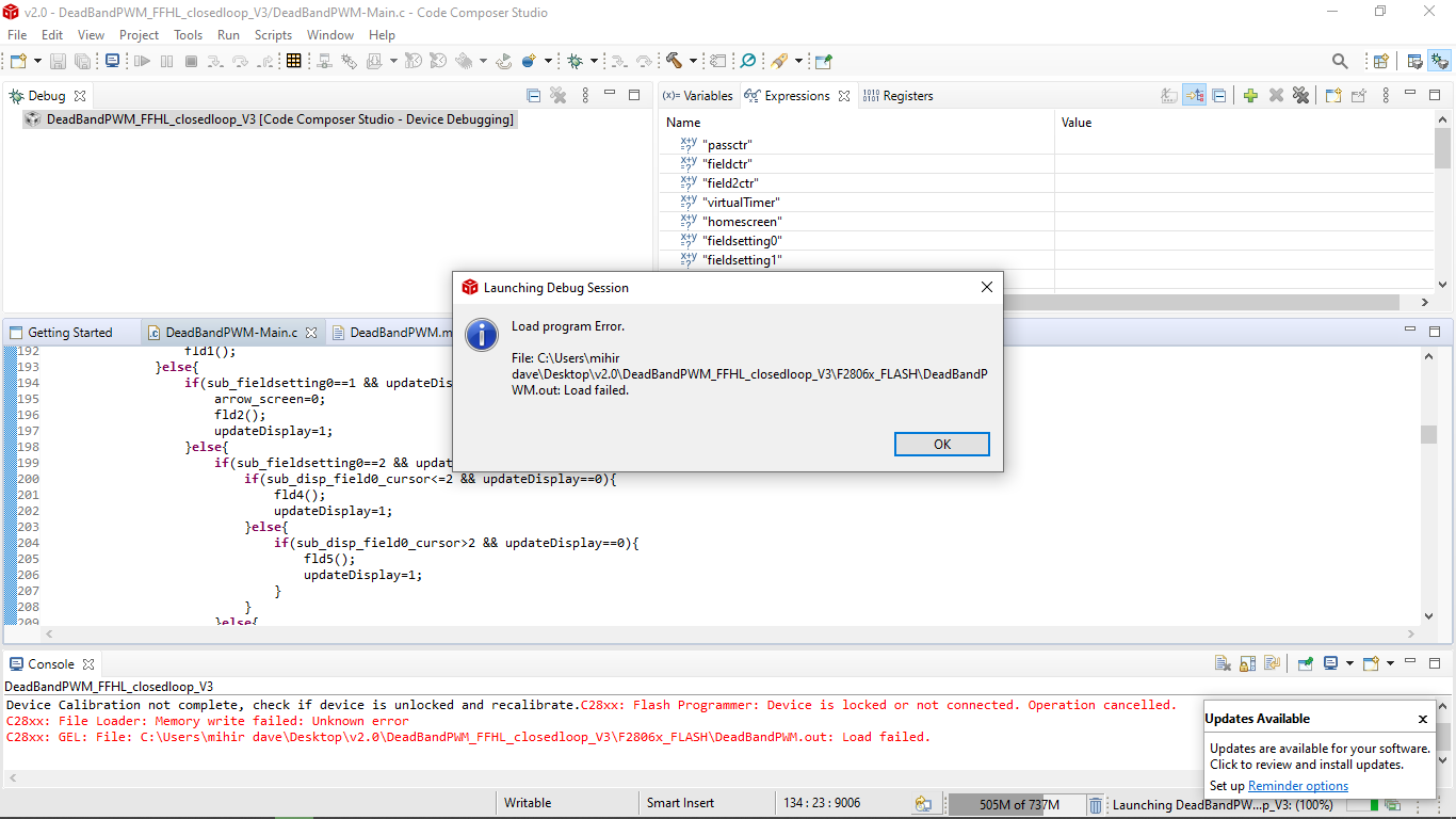

Whenever I try to load program to "TMS320F28069" experimenters kit, using ccs.
Loading program to "FLASH".
I receive this error.
.Please anybody can suggest me any solution for this?

Is have launched target with target configuration file as target.
Than tried to connect c28x cpu.
But it is giving error "no power/clock" to cpu.
Thank you
Hi Mihir,
How are you powering the experimenter kit? If you double click the target config file in the "CCS Edit" view and then select "Test Connection", does the test succeed?
See the below app note for JTAG/Connection debugging steps:
https://www.ti.com/lit/spracf0
Kevin
