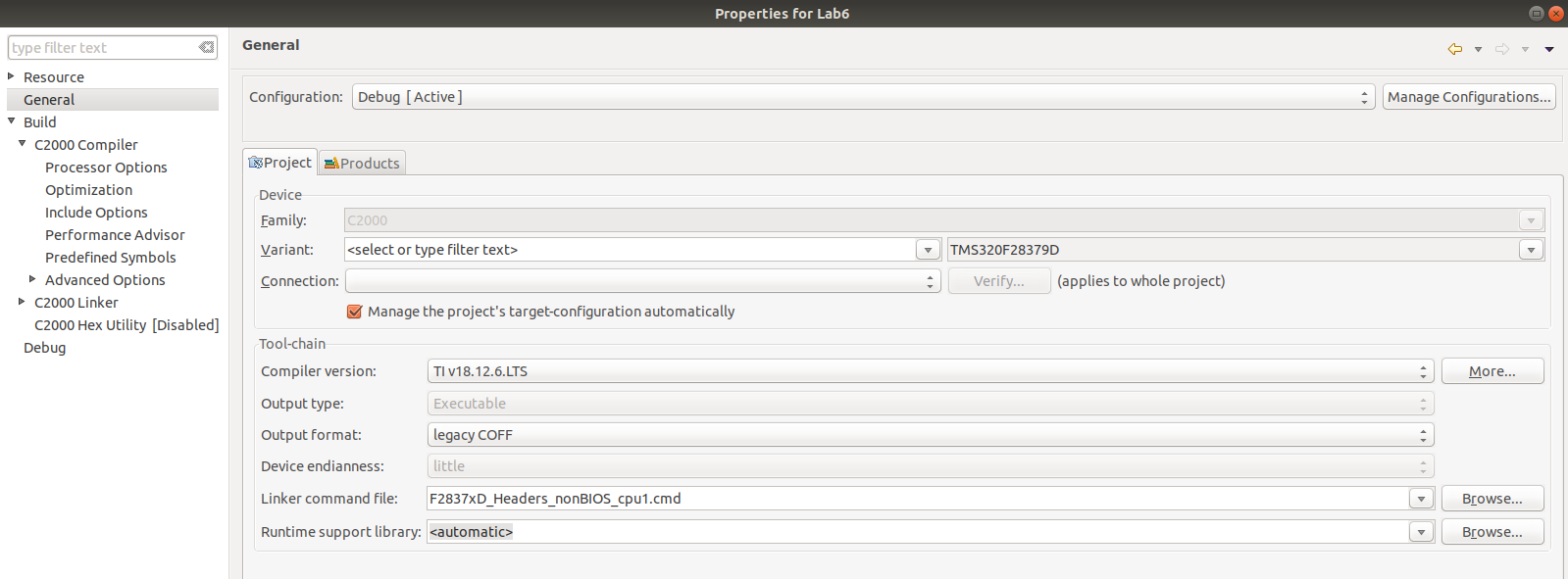

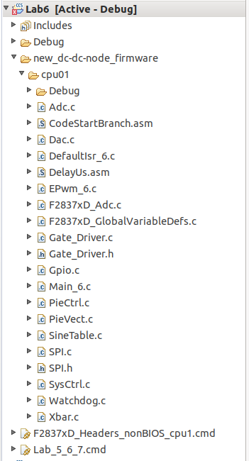

I have attached the file structure and the project properties window for your reference.
The following is my folder structure. The git, whenevr it clones the repo, generates cpu01 file within another folder. Dont know if that is a problem.
The project properties pane is shown below:
I'd appreciate any help regarding this matter.

  • Hi Kartikeya,
    Can you send the full compilation log?
  • Hi Santosh,
    Here you go:

  • Hi Santosh,
    The compiler is able to compile similar lab files without the git repo in them without a problem. It is only not compiling for this lab that has git in it. I am thinking it is a linker file problem. But am not sure.
    kartikeya
