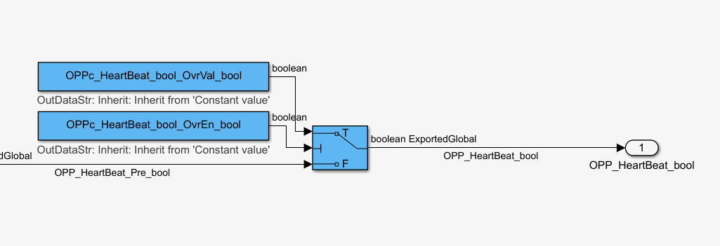

The point that I think it may be a TI question is that in the following picture HOP_Doh_Do3_bool doesn't change GPIO9 if the source of this signal was modified via CCP:
OPP_HeartBeat_Pre_bool is cycling between 1 and 0 every second and the output GPIO9 works correctly, also cycling:
If I change, via CCP, OPPc_HeartBeat_bool_OvrEn_bool, then OPP_HeartBeat_bool assumes the value of OPPc_HeartBeat_bool_OvrVal_bool =0 and GPIO9 goes low.
If I change  OPPc_HeartBeat_bool_OvrVal_bool to 1, then HOP_Doh_Do3_bool Goes back to true and so does GPIO9 but it doesn't go low again even with OPPc_HeartBeat_bool_OvrVal_bool and HOP_Doh_Do3_bool are both false.
Software wise OPPc_HeartBeat_bool_OvrEn_bool has no effect from the moment it goes true since even if I make it false, OPP_HeartBeat_bool  doesn't follow OPP_HeartBeat_Pre_bool as it did initially before any override was changed.
I've been through memory allocation as I cannot understand how the switches stop working but maybe there's some other issue here since the GPIO simply doesn't follow what HOP_Doh_Do3_bool from the moment it goes through a switch.
All my parameters are on RAMGS_DATA which seems correct (Global shared RAM).
This seems to be related to the true value, from false to true it seems to be fine but not the other way around.

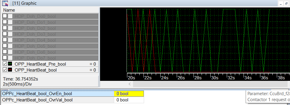

  • Hi Matthew,
    I can't pin down the exact extract of code as this goes through a few delays and data type conversions but previous to the override, all works as expected. The following picture shows this, I changed OPPc_HeartBeat_bool_OvrEn_bool to 1 and then back to 0, you can see the "Pre" continues oscillating (green) while the "Not Pre" (red) stops when OPPc_HeartBeat_bool_OvrEn_bool is true, but it doesn't resume when OPPc_HeartBeat_bool_OvrEn_bool is false:

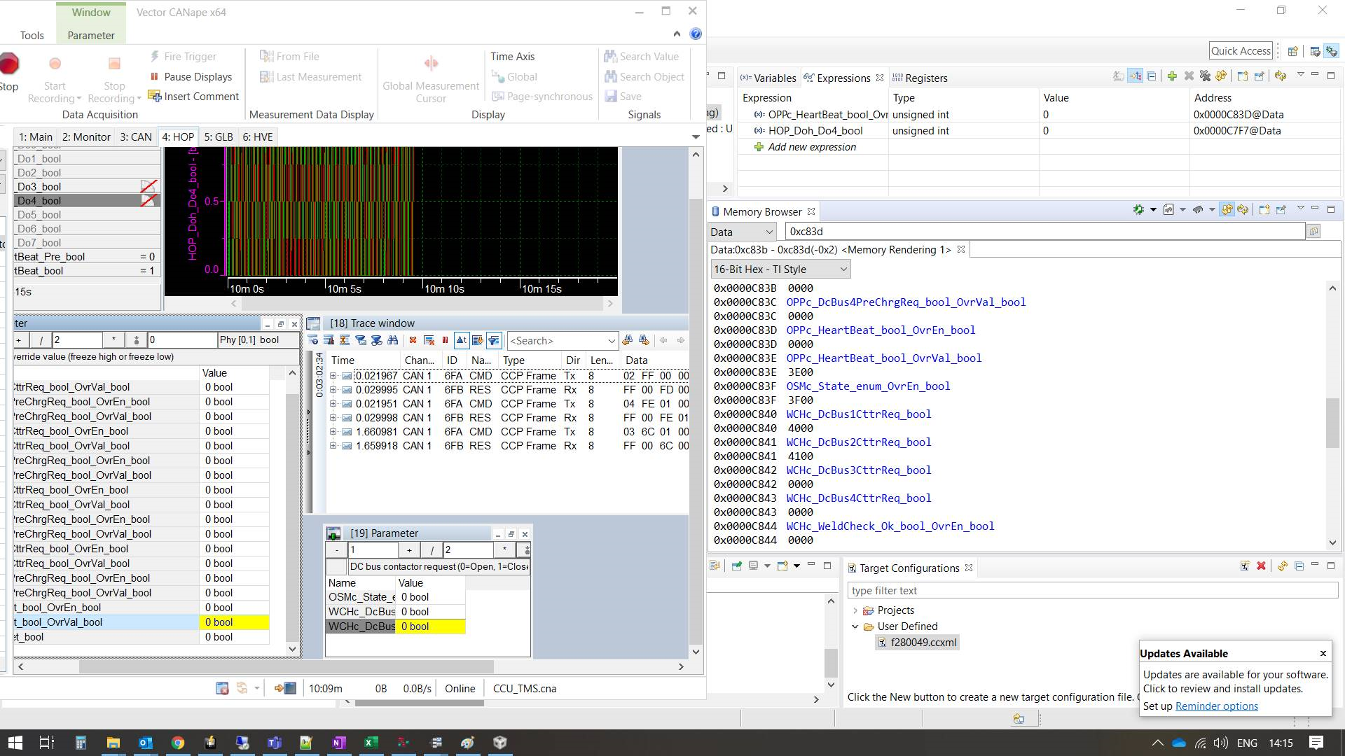

    Indeed, I spent 3h on a call trying to debug this.

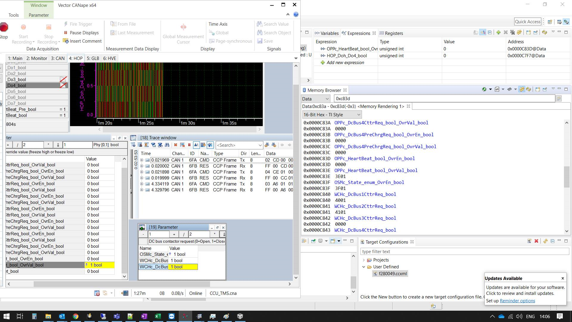

    The picture below shows CANape (CCP tool) on the left and Memory browser on CCS on the right.
    Using CCP I changed the values of OPPc_Heartbeat_bool_OvrVal_bool, OSMc_State_enum_OvrEn_bool, WCHc_DcBus1CttrReq_bool and WCHc_DcBus2CttrReq_bool  to true and they all changed from 0000 to the bolean value preceded by the last byte of the memory address, indicating that the CCP block is not decoding it properly before writing into the memory.
    I changed the value back to false and the last bit indeed changes, but the first byte remains the parameter’s address last byte:
    We don't have a solution yet as I can't change the CCP block myself but I hope Mathworks are revising that block.

    After a lot of debugging I finally found the solution and now I can calibrate all data types.
    Copy the file attached into C:\ProgramData\MATLAB\SupportPackages\R2020a\toolbox\target\supportpackages\tic2000\src.
    I've already informed Mathworks so they can release a bug fix soon.
