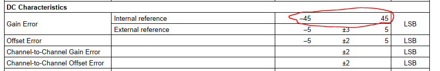

I see that the GAIN error of the ADC with internal reference has about +/- 45 LSB, it looks that this is pretty big, is there any way to do a self-calibration? Thanks...

It is possible to do self-calibration, but this would require sampling a high-accuracy voltage source, then scaling all the ADC results via CPU post-processing.
A much better solution would be to feed the higher precision voltage source to the ADC VREFHI pin directly while using external reference mode instead of internal reference mode.
