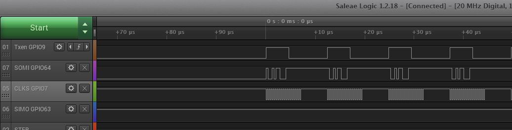

    Monitor GPIO9 which is the TxEn pin along with GPIO64 (SOMI) and I've also monitored GPIO7 (clock slave).   My goal is to see if one of the pins is not toggling and if so then investigate if something on the board could be holding it.  Maybe a jumper on the board, as an example.
    It should look like this:
  • Hi Lori,
    Here is the waveform I got.  EN & CLK looks OK. But no MOSI&MISO.
    And where can I find the code about how to operate SPI? I want to try to send some normal spi data to the pins.

  • Hi Lori,
      I tried the samples you mentioned, SPI works well.  I changed the spi pins to GPIO63/64/65/66, it can also  send out data correctly.
      I found that these four samples call SPI_Config() function, but no such code in T-format example. Should I call it manually? Or it has been called in T-format lib?
      And, GPIO64 is SOMI, Did you connect launchpad to a encoder so that GPIO64 has waveform in your last reply? GPIO9 and GPIO7 are the same as yours.
      Thanks a lot for your patient!
      Nick
  • Hi Lori,
        I connect TIDM-1011 to launchPad. GPIO63 has data now just the same as yours. And I add repeat code follow all the "while(tformatData.dataReady != 1)" code. It seems work normal now. But many CRC error. I will test more to get a result. maybe I need to change another encoder.
