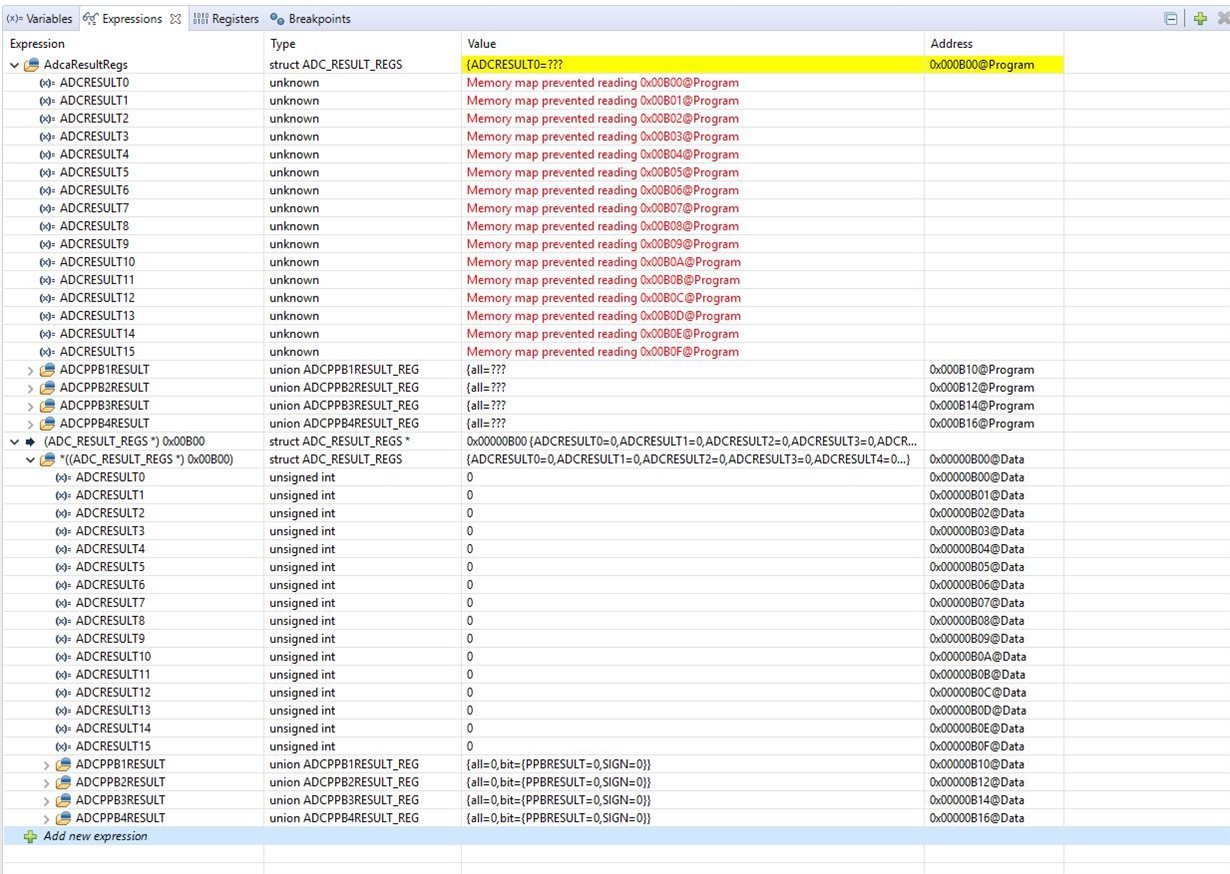

Part Number: TMS320F280025
I found the issue that device register value (eg, AdcaResultRegs) cannot display in CCS expression window while running F280025 project in COFF format as below picture. However the code variables (eg, index) can display well in CCS expression window, and register value can display well in CCS register window.
F280025 example project project from "C2000Ware_3_02_00_00\device_support\f28002x\examples" folder, I change it to COFF format and test by CCS v10.0
Could you help double confirm this issue? If yes, can we have solution to solve the issue, because customer would like to translate their F28035 project base on COFF format to F280025 and keep the COFF format for debugging.
