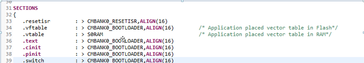

My customer are using Align(16) for each section below: then it should force the linker to align that one section to a 16-byte aligned address.

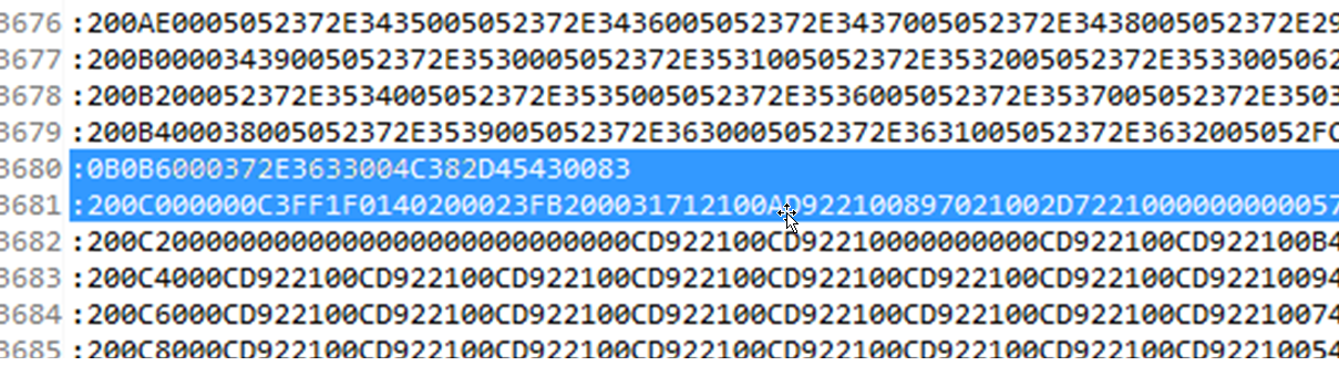

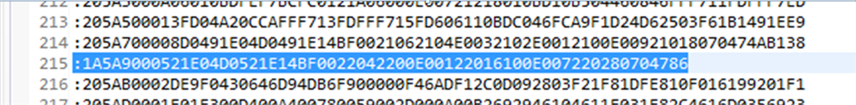

but when take a look at the hex file generated, it did not work as below showed:
the line 215 seem it not 16 byte align.
Also the line 3680 is not 16 byte aligned.
attachment is the cmd file customer use, anything wrong for the result that hex file generated?

SECTIONS
   .resetisr        : > CMBANK0_RESETISR,ALIGN(16)
   .vftable         : > CMBANK0_APP ,ALIGN(16)  /* Application placed vector table in Flash*/
   .vtable          : > S0RAM                   /* Application placed vector table in RAM*/
   .text            : > CMBANK0_APP,ALIGN(16)
   .cinit           : > CMBANK0_APP,ALIGN(16)
   .pinit           : > CMBANK0_APP,ALIGN(16)
   .switch          : > CMBANK0_APP,ALIGN(16)
   .sysmem          : > E0RAM
   .stack           : > C1RAM
   .ebss            : > C1RAM
   .econst          : > CMBANK0_APP,ALIGN(16)
   .esysmem         : > C1RAM
   .data            : > S1_2_3RAM
   .bss             : > C0RAM
   .const           : > CMBANK0_APP,ALIGN(16)
    MSGRAM_CM_TO_CPU1_RT    : > CMTOCPU1MSGRAM0_RT  , type=NOINIT   //must noinit type?why?
    MSGRAM_CM_TO_CPU1_NRT   : > CMTOCPU1MSGRAM0     , type=NOINIT
    MSGRAM_CM_TO_CPU1       : > CMTOCPU1MSGRAM1     , type=NOINIT
    MSGRAM_CPU1_TO_CM_RT    : > CPU1TOCMMSGRAM0_RT  , type=NOINIT
    MSGRAM_CPU1_TO_CM_NRT   : > CPU1TOCMMSGRAM0     , type=NOINIT
    MSGRAM_CPU1_TO_CM       : > CPU1TOCMMSGRAM1     , type=NOINIT
    Identification_Section  : > CMBANK0_APP_META
    .TI.ramfunc : {} LOAD = CMBANK0_APP,
                           RUN = S0RAM,
                           LOAD_START(RamfuncsLoadStart),
                           LOAD_SIZE(RamfuncsLoadSize),
                           LOAD_END(RamfuncsLoadEnd),
                           RUN_START(RamfuncsRunStart),
                           RUN_SIZE(RamfuncsRunSize),
                           RUN_END(RamfuncsRunEnd),
                           ALIGN(16)
  • Those sections are aligned, but the length (the number of words) in the section is not a multiple of the alignment.  If you need that behavior, in the linker command file, replace ALIGN with PALIGN.  For more details, please search the C28x assembly tools manual for the sub-chapter titled Alignment With Padding.

    It work to make length (the number of words) in the section is a multiple of the alignment by using PALIGN, but there have another issue that there are big hole between two section, for example, the address of line 3690 is 0x0B60, and the address of line 3681 is 0x0C00, 0x0C00 - 0x0B60 = 160, so there are 160 byte are filled nothing,  why would have so big size are hole? it should be less than 0x20. how to reduce the hole size between these two section?
    It seem C28x compiler does not have this issue, only CM compiler have this issue.
  • Holes between sections are normal.  How is the output of the hex utility used?  Why does a hole like this cause a problem?
    Thanks and regards,
    -George

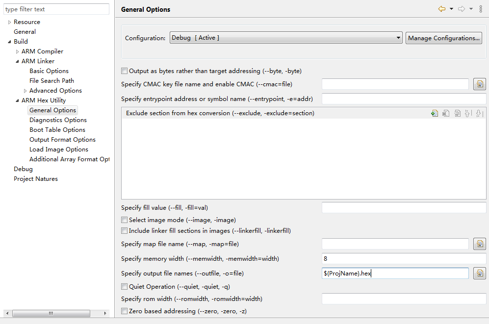

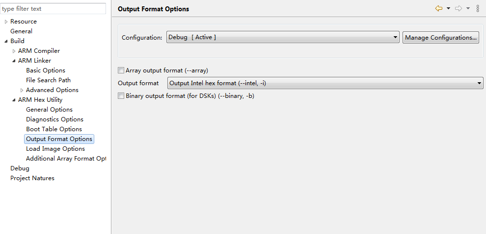

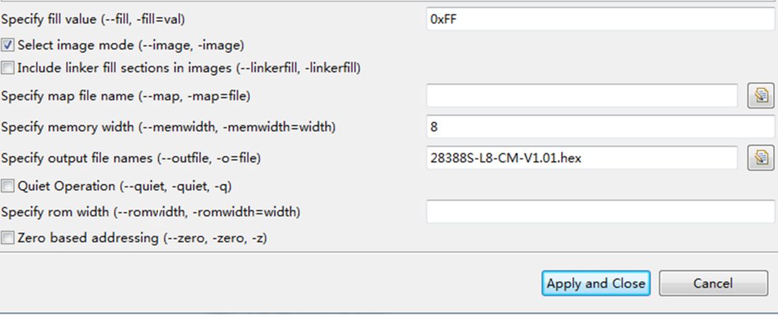

  • the problem is not there have the holes, but the holes size are too big. what customer want is below 30 byte,  the holes size so big will impact the programming by PC.
    below are how customer do the configuration for hex.
    There is no method by which you can limit the size of a hole in memory.  You can either live with them, or eliminate them.  Thus, I presume you want to eliminate them.  There are two methods to consider.
    One method is implemented in the linker command file.  In the MEMORY directive (and not the SECTIONS directive) specify a fill value.  For more details, please search the TI ARM assembly tools manual for the sub-chapter titled The MEMORY Directive.
    The other method is implemented with the hex utility.  Use image mode and the related fill feature.  For more details, please see this forum thread.

  • Hi George
    --> For this method, all the flash sector will be filled with a value, including those that may not be used. what customer want is to only fill the hole between sections with a value.

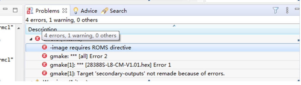

    --> customer try this method, but face an error below, could you suggest how to fix?
  • In reference to using the fill feature on the MEMORY directive, you say ...
    Another alternative is using the fill feature related to the SECTIONS (not MEMORY) directive.  This is more difficult to understand, and I'm not sure it solves the problem.  But, you are welcome to try.  For the details, please search the C28x assembly tools manual for the sub-chapter titled Creating and Filling Holes.
    Regarding image mode of the hex utility you say ...
    When you use image mode, you must supply a ROMS directive.  A ROMS directive can only be supplied in a hex command file, and not on the command line.  This forum post demonstrates the details.
