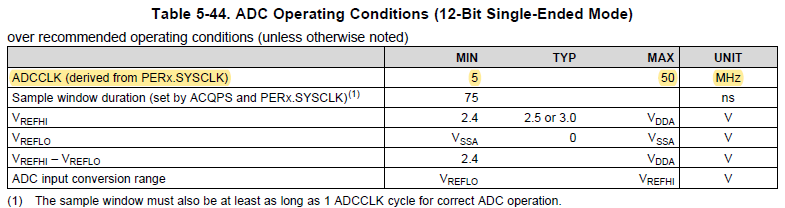

    Do keep in mind that the ADC module has a maximum operating frequency of 50-MHz so setting AdcaRegs.ADCCTL2.bit.PRESCALE to 0 is not valid when SYSCLK is configured for 200-MHz.

    Thanks for pointing out the prescale setting issue. I set it to 6, no luck though. What else could be wrong ?
