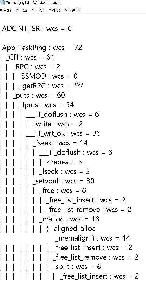

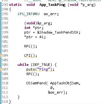

The order of the code I wrote is to call the CFI function after calling the RPC function.
However, the result of the call graph generated by call_graph.pl is called CFI first, and the RPC function is called.
Aren't you creating a call graph by using the executable code and symbols of the .out file?
What am I not sure about?, Can I get the correct answer by analyzing call_graph.pl?
And it turns out that puts -> fputs -> TI_doflush -> _write etc. are called in order. Is this function correct to call functions belonging to the library?
Thanks and Regards
Han
  • The graph produced by call_graph is a static call graph.  It is developed by processing the Dwarf debug information the compiler puts in the executable.  No attempt is made to produce a dynamic call graph, which is based on information collected while running the application.
    For example, if a function is written ...
    void parent()
        zzz();
        aaa();
        /* and so on */
    The call graph shows something similar to ...
    parent
    |   aaa
    |   zzz
    The list of functions is accurate, but may be in a different in which they are called when executed.
    Thanks and regards,
    -George
