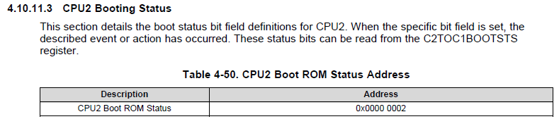

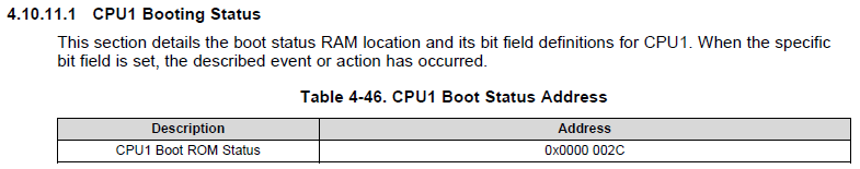

I also had a look at the BOOT-STATUS word you proposed, and it looks OK to me on both CPUs. Unfortunately it reflects the status of a correctly working system, with no NMI pending, since the suspicious flash sectors have already been erased.

Sieghard,
Please check if this is applicable for your debug: Search for "Why is a NMI (due to double bit errors) occurring when Fapi_setActiveFlashBank() is called on F2837xD CPU2?" in flash wiki at https://processors.wiki.ti.com/index.php/C2000_Flash_FAQ
