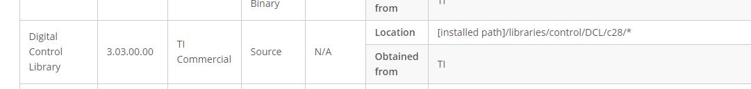

  • Hello Troodon,
    In the root directory of C2000Ware, there is a manifest file.  This lists all of the licenses for content within C2000Ware.
    (ex: C:/ti/c2000/C2000Ware<version>/C2000Ware_<version>_manifest.html )
    Any of the content listed as "TI Commercial" falls under the click-wrap license that you accepted when downloading C2000Ware.   For example, the library that Han mentioned:
    The second license you show in your post is a BSD-3-Clause license.  This is a standard open-source license.   If somehow "all rights reserved" is also included, that is a mistake.
    If you take a look at the manifest you will also find some other licenses that we have passed through from 3rd parties.
