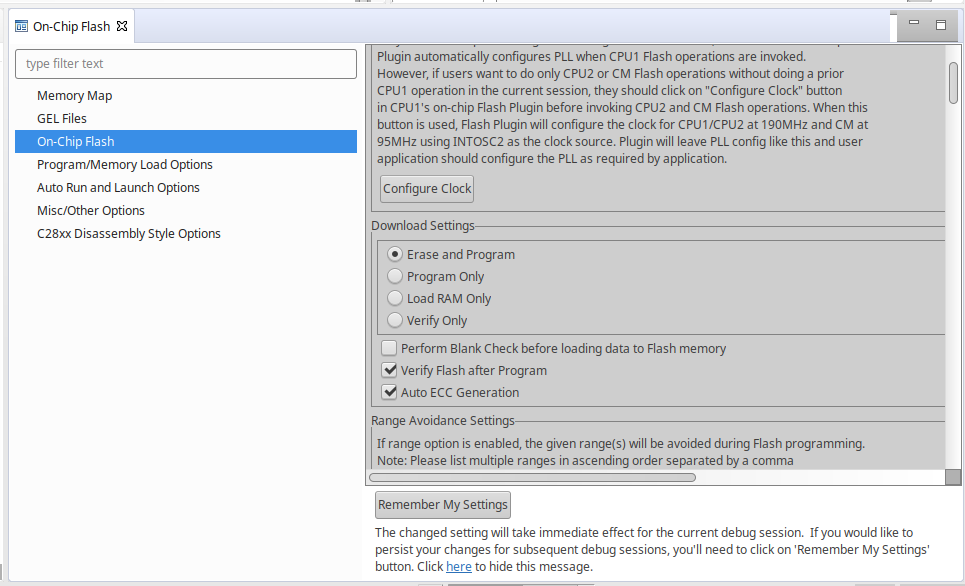

    I also looked at the advice.
    The AutoEccGeneration is checked
    I also tried disabling watchdog by changing the first line of the f2838x_codestartbranch.asm but nothing happened.
