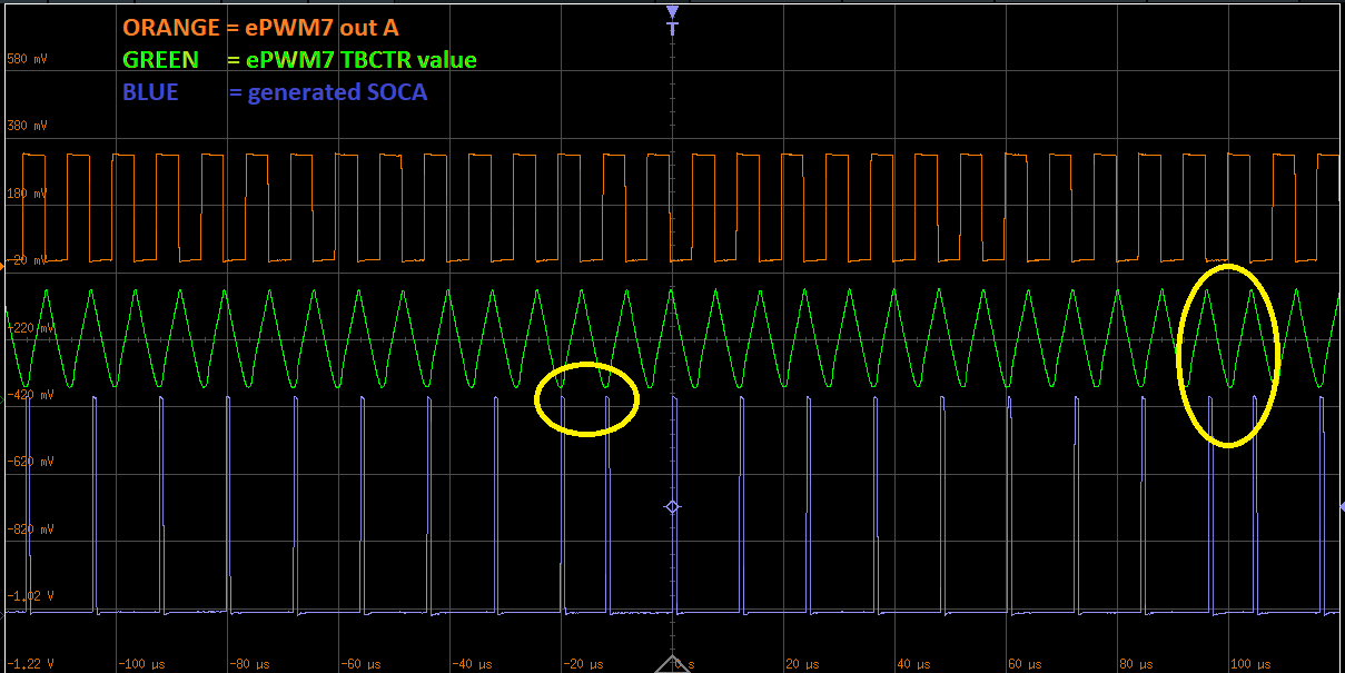

I am using PWM7 to generate SOC every 3rd time when TBCTR == ZERO or PRD. I change TBPRD value in interrupt from 400 to 401 . If I do not use global load everything works as expected. However If I also use global load in oneshot mode to load TBPRD value from shadow to active at TBCTR == PRD then the problem occurs. (Moreover It does not occur if shadow to active goes in TBCTR == ZERO).
The problem is that the SOC is every 3rd event, but sporadically it is every 2nd event. (Same if it is every 7th event, it sporadically happens every 6th event)
Here it is how it looks like:
Why this happens?
  • The circled pulses are when the global load is triggered?
  • I change period
    EPwm7Regs.TBPRD = bSwitch ? 400 : 401; // change period
    and trigger the oneshot load for next TBCTR = PRD within the interrupt
    EPwm7Regs.GLDCTL2.bit.OSHTLD = 1; // FORCE ONE SHOT LOAD for period
    both within the ADC SOC interrupt which is marked with blue signal in the oscilloscope printscreen above.
  • I trigger global load each time at SOC. Cycled pulses occurs sporadically.
    Can you reproduce it? Shall I share a source code with you?
  • You change the PERIOD ON EVERY THIRD (every SOC)?
    At some point SOC gets generated on CTR=PRD, then you change the PRD to PRD + 1 then the CTR keeps counting up, and hits CTR= NEW PERIOD.
    An extra event is detected. This is a race condition issue. make sure you change your preiodat a suitable time, not a time that is too close to your events in this specific case.
    Nima
  • I don't think this is race condition issue.
    If CTR=PRD triggers SOC and then CPU is interrupted at EOC that is the time when I set PRD+1 into shadow register and require global load to do one shot load when CTR = ZERO.
    I am attaching the source code. Please try to reproduce the problem and let me know what you think that could be the problem.

  • Can you try something for me?
    Instead of changing from 400 to 401, can you try switching to 450 and see if the issue still exists?
    Nima
  • Yes, the problem still exists if you change any values.
    Can you try something for me? Please use the source code I attached in previous message and try to reproduce it locally at your device. It has no hardware dependency.
    I need you to confirm if this is a hardware bug in periphery or what is wrong.
    I am waiting for too long for an answer.
  • Yes, I can try this on my HW. Are you using Launchpad or Control card?
  • I am using Control Card

    Nima
  • Juraj,
    Please make sure to confirm that removing the line:
    ADC_setVREF(ADCA_BASE, ADC_REFERENCE_INTERNAL, ADC_REFERENCE_3_3V); // VREF internal 3.3V
    Still causes the issue. I have to test this on an F2837xD control card and had to port your code over before I can test it.
    They have the same EPWM module so we should be able to test this scenario.
    Nima
  • Yes, it still reproduces my issue.
  • Okay I am running it on my setup, but unfortunately I dont see the closer pulses...
    Is there another way to detect this maybe? a timer to capture the closer pulses? Maybe my scope is not capturing enough pulses?
  • This code isn't changing the period at all.
    I tried changing the:
    EPwm7Regs.TBPRD = bSwitch ? 5000 : 5001;
    And it doesn't change the distance between the pulses. Meaning the new PRD value is being written to the register but the new PRD is not being shadow loaded.
    Nima
  • You have global load mode left ON...
    You must turn this off for shadow loading on CTR=ZERO to happen again.
    HRPWM_disableGlobalLoad(EPWM7_BASE);
  • I recommend, to improve this debug experience, please remove ADC, use EPWM interrupt, then instead of trying to catch the error on oscilloscope, lets set up a timer and detect an error when the delay between the interrupts is not the same as expected.
    Currently I have a hard time recreating this for you.
    With the original code you sent, the PRD is not even loaded with the new value in the ISR.
    Nima
  • Juraj,
    Were you able to look at my results?
    If you can send me an ePWM only code where the issue occurs, I can test again on my device.
    Nima
    You have the source code where the issue occurs. The problem is generating of SOC for ADC so I cannot do it without ADC module.
  • Juraj,
    Can you modify the code you send me to have CPU TIMER, which counts the number of cycles between ISRs, and when the ISRs are too close, we can set a GPIO high?
    This way maybe we can definitively catch it on the scope? Currently with the version of the code I have, I am not able to replicate this.
    Nima
  • Juraj,
    Were you able to add in the CPU TIMER so we can catch the anomaly in SW?
    Nima
  • I was not able to add CPU timer. Could you please try to add CPU timer?
