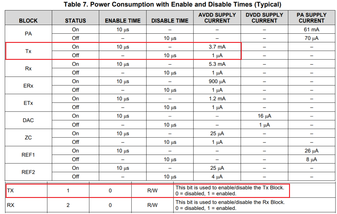

Hi support,
I am working on the example code: boostxl_afe031_f28004x_dacmode and boostxl_afe031_f28004x_rx. The bit rate is set to 1/5.12ms=195bps, which is way too slow. I tried to increase it by 10 times with following mod:
#define EPWM2_TIMER_TBPRD 1600 // (on _dacmode)
#define EPWM2_TIMER_TBPRD 1067 // EPwm2 Period register, 10666 ==> 586Hz (on _rx)
The signal output from the TX board looks fine, but there's no respond with the RX board. However when I tried with 2 times
#define EPWM2_TIMER_TBPRD 8000 // (on _dacmode)
#define EPWM2_TIMER_TBPRD 5334 // (on _rx)
Then it works fine.
Can you help to point out what I did wrong?
