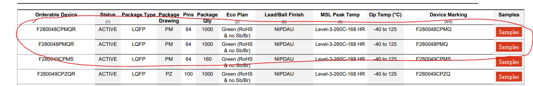

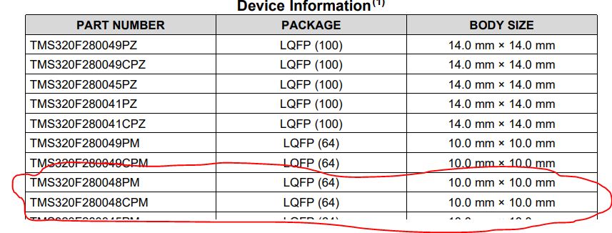

Hi, I have a doubt about finding the difference between the two chips listed below.
TMS320F280048PM & TMS320F280048CPM.
There Package type, package drawing, pin count, size even package quantity.
The only difference I can find is the device marking.

Hi Shibin,
TMS320F280048CPM : This part has CLB where as TMS320F280048PM does not have CLB (Configurable Logic Block).
You can use https://www.ti.com/microcontrollers/c2000-real-time-control-mcus/products.html
Hi Santosh,
Thank you for your reply.
But nowhere in the datasheet, it is mentioned about the difference between those two chips.
I think all the rest of the things are common for both chips.
THe data sheet is for F28004x device family. For difference, but go the individual product page.
http://www.ti.com/product/tms320f280048c?qgpn=tms320f280048c
