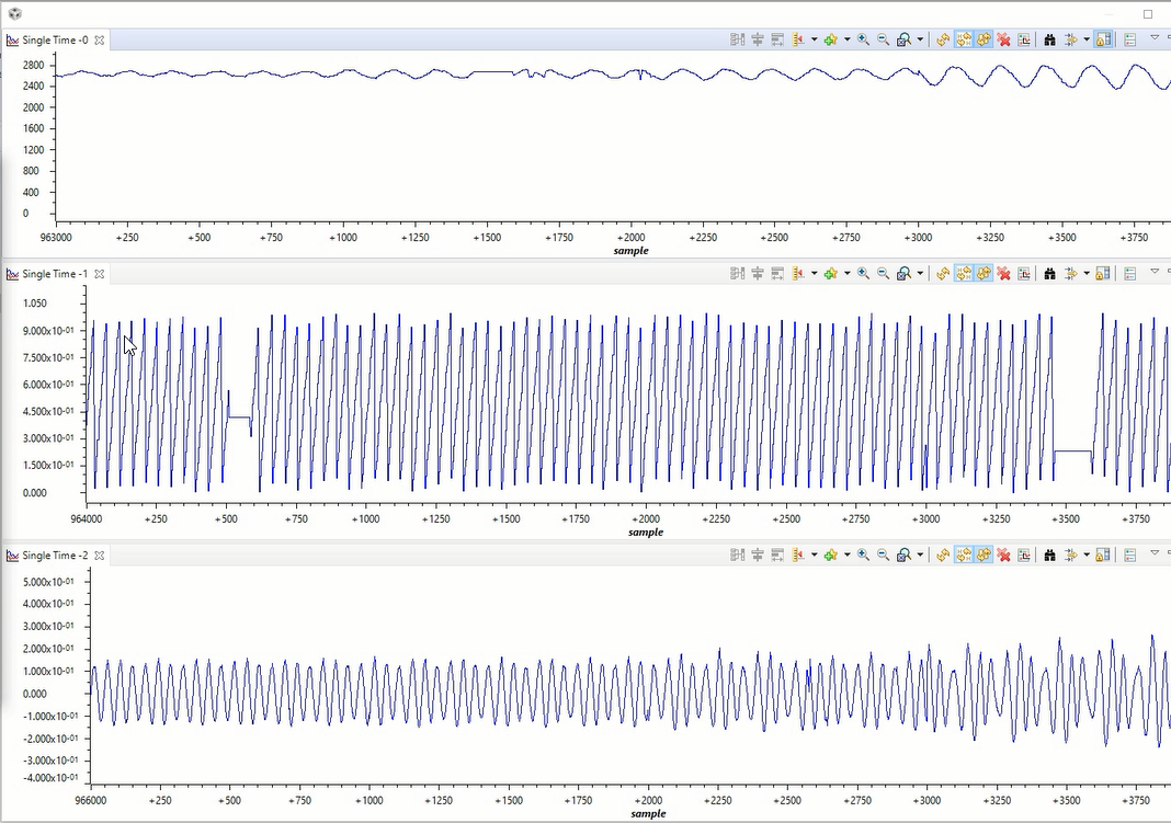

  • Could you please post some phase current waveforms of the motor to show the problem? What speed is the motor running at? And any load on the motor?
    Did you try to use the graph tool with datalog to check the rotor angle and feedback speed? If not, you may refer to the lab01b and lab01c to use this graph tool.
    Did you try to use the TI EVM board to identify and run the motor if possible? And compare the testing result with your own board? Please make sure that the current and voltage sensing signals are good enough on your own board.

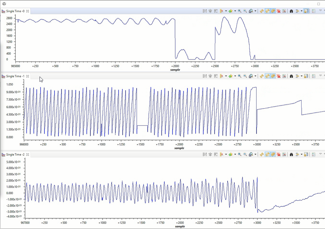

    I have tried plotting feedback-speed (single time-0), feedback-angle (single time-1) and motor-current (single time-2) in the graph tool using datalog method as suggested within Lab-1b. Below is the code implementation.
    Have defined the buffer in main.c itself
    #define DATA_LOG_SIZE 1000
    uint16_t datalogbuff0[DATA_LOG_SIZE];
    float datalogbuff1[DATA_LOG_SIZE];
    float datalogbuff2[DATA_LOG_SIZE];
    #pragma DATA_SECTION(datalogbuff0,"graph_data");
    #pragma DATA_SECTION(datalogbuff1,"graph_data");
    #pragma DATA_SECTION(datalogbuff2,"graph_data");
    In the mainISR
    datalogbuff0[cntr] = (uint16_t)(_IQtoF(gMotorVars.Speed_krpm)*1000);
    datalogbuff1[cntr] = _IQtoF(gMotorVars.est_angle_pu);
    datalogbuff2[cntr] = _IQtoF(gAdcData.I.value[0]);
    Also, I have attached the video of the graph tool while running in debug mode. In the video you will see, custom GUI is being used to command reference speed, which is also being used for monitoring few parameters. In the beginning, the motor is started at 80Hz and later on frequency is increased in steps of 2 to 5Hz. At around 88Hz motor vibrates and stop (at time 01:48 in the video). From the graph data you can observe that at this frequency, motor current amplitude starts oscillating, hence the ripples in feedback-speed increases.
    You will find the current waveform in the video, Single Time-2 tab is used for output current. Till 88Hz motor runs fine. The motor is connected to the submersible pump.
    Yes, video is attached.

    Could you please post some captured current waveform directly since the Video can't be supported? Did you have the inductance vs. current curve of the motor? If not, you might ask for this data from the motor manufacturer to see if the inductance changes a lot with the increasing current. If yes, you have to change the motor parameters on the fly according to the spec. of the motor as the lab13 in MCSDK. The inductance table in lab13 is just for reference, you should set the inductance table based on the spec. of the motor.
    Did you meet the vibration during the motor is tested with a full load? Or without loading at the motor is just connected to the pump?
  • Hi Yanming
     Am attaching the video in another format. Also attaching the screenshots of the video, in case if this time also the video doesn't work.

  • I don't think the rotor angle in the figure above is correct. You might try to use a lower Kp&Ki of the speed PI controller for the high speed, and tune the current controller as well.
