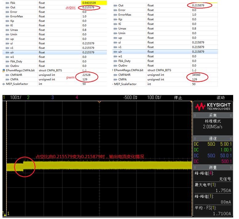

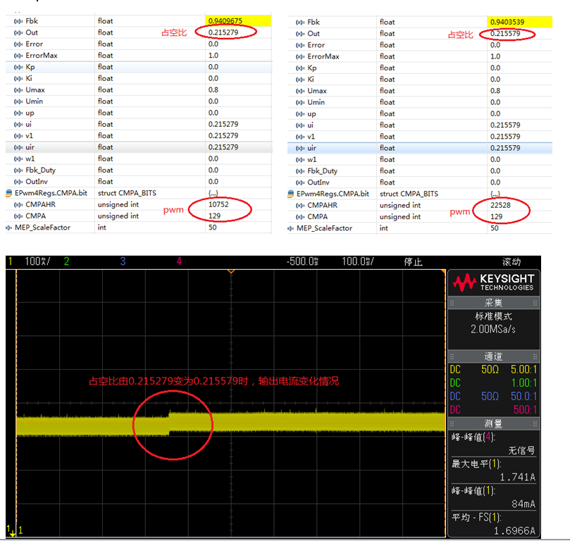

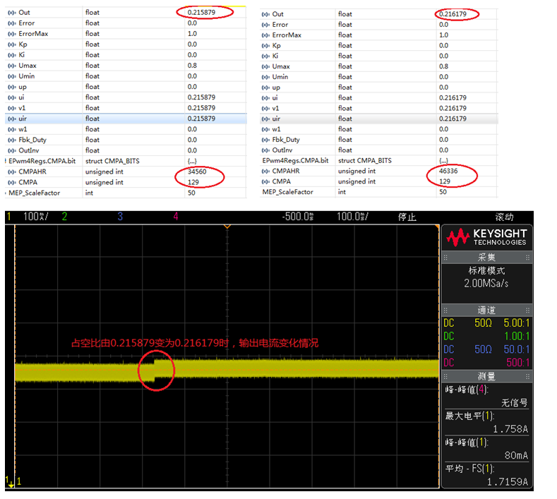

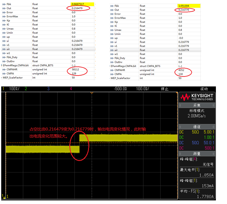

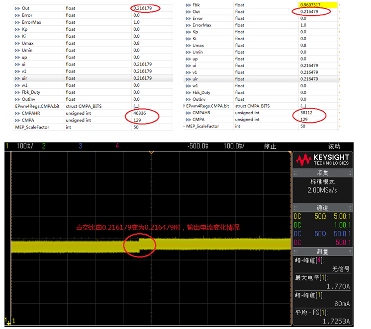

my customer is using HRPWM to output a duty cycle PWM to drive the high side of a buck controller.
In theory the output current should be proportional to the duty cycle of the buck converter. So by looking at the current we could see the duty cycle of the PWM generated.
We can't use an scope to measure the duty cycle because the resolution is not enough to see such small change in duty cycle.
We get the result below:
duty cycle expected duty cycle increment CMPA CMPAHR current measured current expected TBPRD
0.215279 129 10752 1 1 600
0.215579 0.003 129 22528 1.1 1.2 600
0.215879 0.003 129 34560 1.2 1.4 600
0.216179 0.003 129 46336 1.3 1.6 600
0.216479 0.003 129 58112 1.4 1.8 600
0.216779 0.003 130 4352 2 2 600
There will always be a big jump of current at the increment by 1 of CMPA.
The setting is as below, auto conversion is enabled.
EPWM1Regs.CMPA.all=(Uint32)((float)DutyToCmpCst*(dutycycle));
DutyToCmpCst=TBPRD<<16=600*65536.
1.Duty cycle jump from 0.215279 to 0.215579: waveform is average current
2.Duty cycle jump from 0.215579 to 0.215879:
3.Duty cycle jump from 0.215879 to 0.216179:
4.Duty cycle jump from 0.216179 to 0.216479:
5.Duty cycle jump from 0.216479 to 0.216779:
So we suspect the duty cycle is not incrementing as we expected, but we don't know where are things wrong.

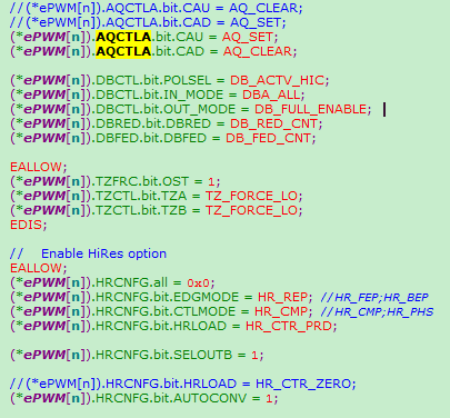

  • First point from your c code, in HRPWM CTR UP-DOWN mode, you MUST use shadow load mode at CTR=ZRO and PRD.
    Nima
  • Nima,
    do you mean that we should use shadow load mode at both CTR=ZRO and PRD, not only PRD?
    Why?
    Have you tested with the same configuration with ours, and can you repeat the same result?
    Thanks.
  • Okay after reviewing the whole code, the only thing I see that is not correct in the setup is:
    1. Your shadow load modes in Up-Down count:
    	(*ePWM[n]).CMPCTL.bit.LOADAMODE = CC_CTR_PRD;
    	(*ePWM[n]).CMPCTL.bit.LOADBMODE = CC_CTR_PRD;
    These MUST to be CC_CTR_ZERO_PRD.
    2. For your HRPWM, you need to:
    	(*ePWM[n]).HRCNFG.bit.EDGMODE = HR_FEP;
    	(*ePWM[n]).HRCNFG.bit.CTLMODE = HR_CMP;
    	(*ePWM[n]).HRCNFG.bit.HRLOAD = HR_CTR_PRD;
    The edge mode needs to be BOTH edges in Up-Down mode: HR_BEP
    The HRCNFG CTLMODE is correct.
    The HRLOAD again MUST be : HR_CTR_ZERO_PRD
    Can you test this on your setup?

    When using TBCTR in UP-DOWN count with the HIGH-RESOLUTION module, the use MUST use shadow load modes of ZERO_PRD. The values inside the CMPx register have another layer of internal shadows, which MUST BE UPDATED internally (not done by the user) at ZERO_PRD.
    Nima
  • Howard,
    1. yes the hrpwm_config is not used.
    2. yes the PWM_1chHiResUpDwnCnt_CNF is used.
    When using TBCTR mode UP-DOWN, and you want to use Duty control, YOU MUST have the following configuration:
    EDGE mode BOTH
    CONTROL mode DUTY (in fact the TRM only says “this is duty or period control mode”) THIS IS CORRECT. It says DUTY but it actually is DUTY AND PERIOD.
    SHADOW mode ALWAYS (PRD AND ZERO) this is MUST. The internal logic of EPWM will not operate correctly if that is not the case.
    The duty/period control, will give you HR-MODE access to period and for the duty control , the CMPAHR increase part moves one edge (the rising edge before the PRD), closer to the PRD while it moves the falling edge AWAY from the PRD. so it either increases your duty or decreases your duty but shifting both edges closer to each other or away from each other.
    Howard, possibly the three examples I have created for you could help understand the setting for the code you need.

            HRPWM_setMEPEdgeSelect(ePWM[j], HRPWM_CHANNEL_A, HRPWM_MEP_CTRL_RISING_AND_FALLING_EDGE);
            HRPWM_setMEPControlMode(ePWM[j], HRPWM_CHANNEL_A, HRPWM_MEP_DUTY_PERIOD_CTRL);
            // Set up shadowing
            // MUST BE CTR=(ZER & PRD)
            HRPWM_setCounterCompareShadowLoadEvent(ePWM[j], HRPWM_CHANNEL_A, HRPWM_LOAD_ON_CNTR_ZERO_PERIOD);
    #if CHANNEL_B_AS_ZRO_PRD_REF == 0
            HRPWM_setMEPEdgeSelect(ePWM[j], HRPWM_CHANNEL_B, HRPWM_MEP_CTRL_RISING_AND_FALLING_EDGE);
            HRPWM_setMEPControlMode(ePWM[j], HRPWM_CHANNEL_B, HRPWM_MEP_DUTY_PERIOD_CTRL);
            // Set up shadowing
            HRPWM_setCounterCompareShadowLoadEvent(ePWM[j], HRPWM_CHANNEL_B, HRPWM_LOAD_ON_CNTR_ZERO_PERIOD);
    #endif
            HRPWM_enableAutoConversion(ePWM[j]);
            // Turn on high-resolution period control for DUTY to take HR on BOTH EDGEs.
            HRPWM_enablePeriodControl(ePWM[j]);
            HRPWM_disablePhaseShiftLoad(ePWM[j]);
