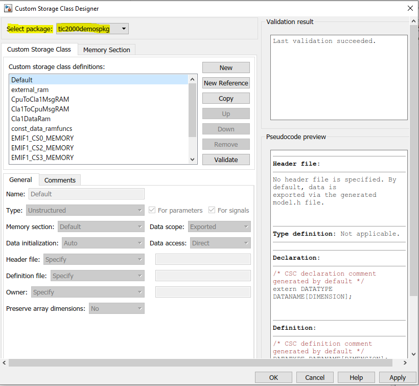

You can verify the pre-existing custom storage classes by running "cscdesigner" in MATLAB command window. It will populate Custom Storage Class Designer window.
Select the tic2000demospkg package.
Note the above Memory sections namely code_ramfuncs and const_data_ramfuncs can be used to store the code and data in the ROM and this will be copied to RAM during execution which improves the overall performance of the system.

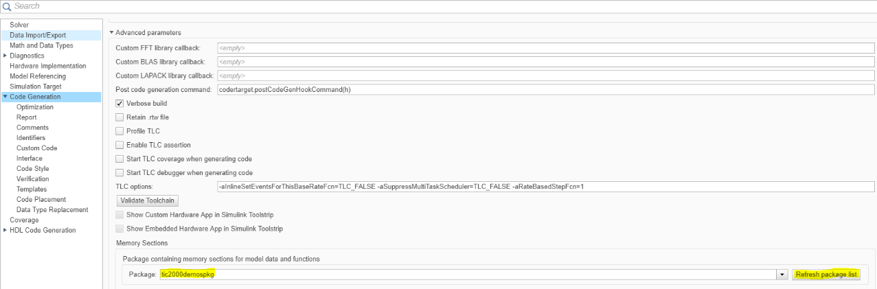

If you cannot find the tic2000demospkg above under the Select package, you can select the same from code generation configuration parameters as shown below. You may wish to search for “memory sections” from the search bar in configuration parameters to more easily see this option.
