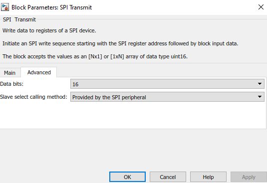

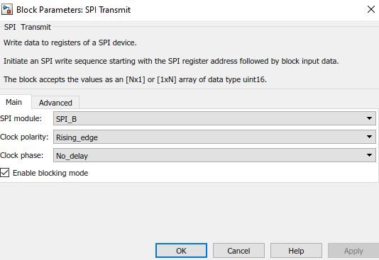

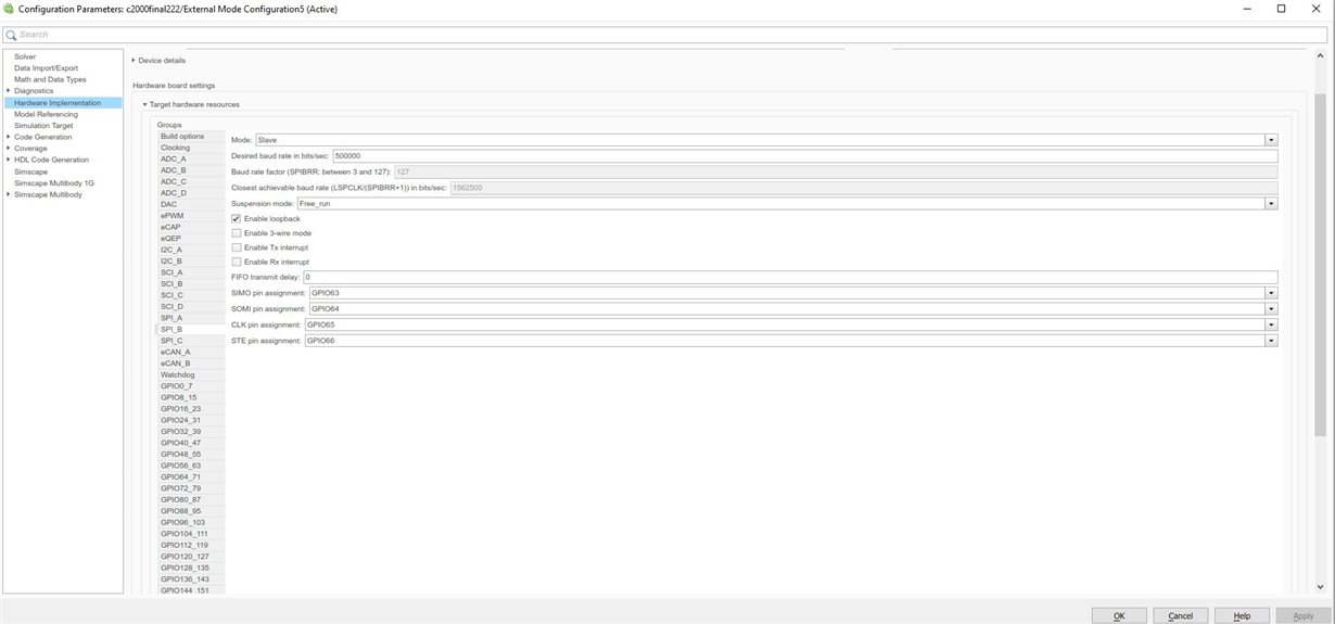

  • and here the code for spi generated by simulink i have zero experience with ccs so icant understand it or which file there you want me to open
    /* Copyright 2017-18 The MathWorks, Inc. */ #include "MW_c28xSPI.h" #include "MW_SPI.h" /* Intialize SPI device */ MW_Handle_Type MW_SPI_Open(uint32_T SPIModule, uint32_T MosiPin, uint32_T MisoPin, uint32_T ClockPin, uint32_T SlaveSelectPin, uint8_T ActiveLowSSPin, uint8_T spi_device_type) { #ifndef MATLAB_MEX_FILE MW_SpiHandle mySpi; mySpi = SPI_init(SPIModule); #ifndef MW_F281X if(SlaveSelectPin != MW_UNDEFINED_VALUE) { Set_GPIOPin(SlaveSelectPin, GPIO_MUX_CPU1, 0, GPIO_OUTPUT, GPIO_PULLUP|GPIO_ASYNC); } #endif return (MW_Handle_Type)mySpi; #else return (MW_Handle_Type)NULL; #endif //MATLAB_MEX_FILE } /* Set SPI Communication format for the processor */ /* targetprecision: Bits/frame for processor */ /* spi_mode: Clock polarity and clock phase */ /* TargetFirstBitToTransfer: First bit to be transferred by processor */ MW_SPI_Status_Type MW_SPI_SetFormat(MW_Handle_Type SPIModuleHandle, uint8_T targetprecision, MW_SPI_Mode_type spi_mode, MW_SPI_FirstBitTransfer_Type TargetFirstBitToTransfer) { #ifndef MATLAB_MEX_FILE MW_SpiHandle mySpi = (MW_SpiHandle)SPIModuleHandle; if((mySpi->spi_clk_mode == (Uint16)spi_mode) && (mySpi->charLength == targetprecision)) { // Do nothing when there is no change in the parameters return MW_SPI_SUCCESS; } else { volatile struct SPI_REGS *SPI = (struct SPI_REGS *)mySpi->spi_base_address; // Update the SPI clock mode and Charecter length mySpi->charLength = targetprecision; mySpi->spi_clk_mode = (Uint16)spi_mode; (*SPI).SPICCR.bit.SPISWRESET = 0; if (mySpi->spi_clk_mode == MW_SPI_MODE_0) { (*SPI).SPICCR.bit.CLKPOLARITY = 0; (*SPI).SPICTL.bit.CLK_PHASE = 0; } else if (mySpi->spi_clk_mode == MW_SPI_MODE_1) { (*SPI).SPICCR.bit.CLKPOLARITY = 0; (*SPI).SPICTL.bit.CLK_PHASE = 1; } else if (mySpi->spi_clk_mode == MW_SPI_MODE_2) { (*SPI).SPICCR.bit.CLKPOLARITY = 1; (*SPI).SPICTL.bit.CLK_PHASE = 0; } else { (*SPI).SPICCR.bit.CLKPOLARITY = 1; (*SPI).SPICTL.bit.CLK_PHASE = 1; } (*SPI).SPICCR.bit.SPICHAR = (uint16_T)((mySpi->charLength) - 1); (*SPI).SPICCR.bit.SPISWRESET = 1; return MW_SPI_SUCCESS; } #else return MW_SPI_SUCCESS; #endif //MATLAB_MEX_FILE } /* Set SPI bus speed */ MW_SPI_Status_Type MW_SPI_SetBusSpeed(MW_Handle_Type SPIModuleHandle, uint32_T BusSpeedInHz) { #ifndef MATLAB_MEX_FILE return MW_SPI_SUCCESS; #else return MW_SPI_SUCCESS; #endif //MATLAB_MEX_FILE } /* Configure SPI Slave select pin before starting the transmission if the slave select Pin is not custom */ MW_SPI_Status_Type MW_SPI_SetSlaveSelect(MW_Handle_Type SPIModuleHandle, uint32_T SlaveSelectPin, uint8_T ActiveLowSSPin) { #ifndef MATLAB_MEX_FILE return MW_SPI_SUCCESS; #else return MW_SPI_SUCCESS; #endif //MATLAB_MEX_FILE } /* Initiate combined SPI transmission from master to slave */ MW_SPI_Status_Type MW_SPI_MasterWriteRead_8bits(MW_Handle_Type SPIModuleHandle, const uint8_T * wrData, uint8_T * rdData, uint32_T datalength) { #ifndef MATLAB_MEX_FILE MW_SpiHandle mySpi = (MW_SpiHandle)SPIModuleHandle; volatile struct SPI_REGS *SPI = (struct SPI_REGS *)mySpi->spi_base_address; uint32_T localVar; uint16_T *readdata = (uint16_T*) rdData; uint16_T *writedata = (uint16_T*) wrData; for (localVar = 0; localVar < datalength; localVar++) { while ((*SPI).SPIFFTX.bit.TXFFST == mySpi->fifoLevel) { /*Wait until Tx buffer is cleared*/ } (*SPI).SPITXBUF = writedata[localVar] << (16 - mySpi->charLength); while ((*SPI).SPIFFRX.bit.RXFFST == 0) { /*Wait until Rx buffer has data*/ } readdata[localVar] = (*SPI).SPIRXBUF & (((Uint32)1 << mySpi->charLength) - 1); } return MW_SPI_SUCCESS; #else return MW_SPI_SUCCESS; #endif //MATLAB_MEX_FILE } /* Initiate data communication from master to slave in slave mode */ MW_SPI_Status_Type MW_SPI_SlaveWriteRead_8bits(MW_Handle_Type SPIModuleHandle, const uint8_T * wrData, uint8_T * rdData, uint32_T datalength) { #ifndef MATLAB_MEX_FILE return MW_SPI_SUCCESS; #else return MW_SPI_SUCCESS; #endif //MATLAB_MEX_FILE } /* Get the status of SPI */ MW_SPI_Status_Type MW_SPI_GetStatus(MW_Handle_Type SPIModuleHandle) { #ifndef MATLAB_MEX_FILE return MW_SPI_SUCCESS; #else return MW_SPI_SUCCESS; #endif //MATLAB_MEX_FILE } /* De-initialize or release the SPI */ void MW_SPI_Close(MW_Handle_Type SPIModuleHandle, uint32_T MosiPin, uint32_T MisoPin, uint32_T ClockPin, uint32_T SlaveSelectPin) { }
  • and here the spi configuration from simulink

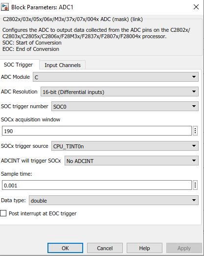

    1)SPI blocking is interfering with the ADC start of conversion frequency.  This would only be true if you are manually triggering the ADC by setting the SOC Force bit in SW.  Can you comment on the trigger source for the ADC channel, i.e. PWM, Timer, or SW?
    2)SPI block is interfering with reading the ADC results in time, before they are overwritten.  To remedy this, I'd like to try and use the DMA to read the ADC results vs the CPU.  Is there an obvious block for the DMA in Simulink?  If so we should point the read function to the ADC result regs, and the destination to a block of RAM big enough to hold your data.
    Let me know if you think #1 or #2 is more likely and if we need help from MW to implement.

  • here the ADC triggering source which is cpu timer 0

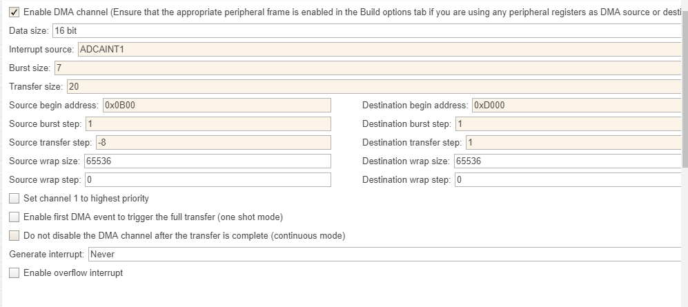

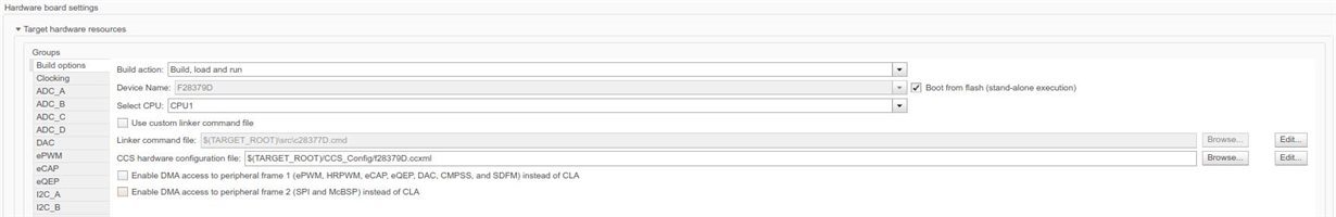

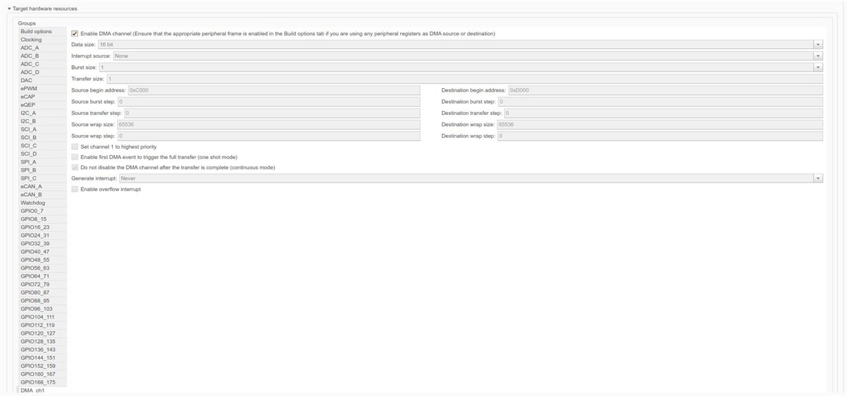

  • and fro DMA
    here what we have in simulink the first the option of DMA in the first pic if i enable it is the same i don't now if i have to configure something else and the second Pic its DMA ch1 configuration but i don't know how to configure it

  • I've attached a screenshot of the DMA setup below; there are likely a few things we need to change to match your setup:
    I believe you are using ADCA, you just need to make sure you are picking the same INT source as you had before for your ISR(you'll want to remove any copy code you had in the ISR itself since the DMA will take care of that).
    For the Burst Size, this is how many ADC samples are taken when it receives its Start of Conversion -1, So in the below case I have assumed there are 8 samples for every SOC.  Please change this accordingly.
    Transfer Size is the length of your data buffer divided by the burst size -1.
    The source begin address is the ADC Result registers 0xB00, and the dest addr is whatever RAM you were storing the results in.
    Burst step is the increment for each burst word, in this case if your sampling the same channel 8 times, we just want to increment through the ADC Result one at a time.  Same for the destination burst step
    Transfer Step is what we want to happen to the source/dest address on each new transfer, in this case for the source we need to make it -8 to start at the beginning of the ADC Result Register each time.  For the dest, we want to place this new data right after the old data, so we just put a "1"
    I've unchecked continuous mode for the sake of debug here, i.e. the DMA will stop once the buffer is full.  You could configure this to on, but the data will be overwritten in your buffer the next ADC SOC.
  • thank you for you response to give you the full picture i am using 7 ADC three for the voltage two for the current which are 3 from ADCA ,Two from ADCC and two From ADCB so what do you recommend in this case i use 3 DMA channels for A and B and C and do i have to change the address ?
    my sampling rate is 0.001s

    I understand the situation.  I'm going to get something more concrete by Tues of next week; but after talking with the MW team I think I understand what the issue may be.  The ADC blocks not only initialize the ADC modules, but they use the CPU to do a periodic read of those result registers(and I think CPU1 Timer is involved as well).  I think that when we block for SPI we are consuming the CPU MIPs necessary to read the output either at all or on time.
    I think there are a few ways around this, I would not use the output of those blocks to read the ADC values, rather I would use the DMA to read the ADC results once they are updated.  We should be able to do this by feeding a ADC interrupt to the DMA block; and then have the DMA copy all/some of the registers to memory.  Once that has completed we can use the DMA to send its interrupt/done signal to the C28x and then read the results that way.
    I will try and get some example Simulink blocks by next week, but if you can find the DMA block you can try to set it up yourself.  I'd recommend taking a look at the DMA chapter in the TRM
