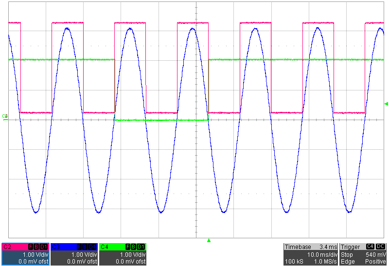

Hi, I use the eCap Function of TMS320F28335 to capture the rising edge and falling edge of red graphs which connected to GPIO24 or eCAP1 pin. I use the code as mentioned in eCAP module reference guide for TMS 320x280x (spru807b),
i initialize this part in main
ECap1Regs.ECCTL1.bit.CAP1POL = EC_RISING;
ECap1Regs.ECCTL1.bit.CAP2POL = EC_FALLING;
ECap1Regs.ECCTL1.bit.CAP3POL = EC_RISING;
ECap1Regs.ECCTL1.bit.CAP4POL = EC_FALLING;
ECap1Regs.ECCTL1.bit.CTRRST1 = EC_DELTA_MODE;
ECap1Regs.ECCTL1.bit.CTRRST2 = EC_DELTA_MODE;
ECap1Regs.ECCTL1.bit.CTRRST3 = EC_DELTA_MODE;
ECap1Regs.ECCTL1.bit.CTRRST4 = EC_DELTA_MODE;
ECap1Regs.ECCTL1.bit.CAPLDEN = EC_ENABLE;
ECap1Regs.ECCTL1.bit.PRESCALE = EC_DIV1;
ECap1Regs.ECCTL2.bit.CAP_APWM = EC_CAP_MODE;
ECap1Regs.ECCTL2.bit.CONT_ONESHT = EC_CONTINUOUS;
ECap1Regs.ECCTL2.bit.SYNCO_SEL = EC_SYNCO_DIS;
ECap1Regs.ECCTL2.bit.SYNCI_EN = EC_DISABLE;
ECap1Regs.ECCTL2.bit.TSCTRSTOP = EC_RUN;
and every 100us it will calculate this one
DutyOnTime1 = ECap1Regs.CAP2; // Fetch Time-Stamp captured at T2
DutyOffTime1 = ECap1Regs.CAP3; // Fetch Time-Stamp captured at T3
DutyOnTime2 = ECap1Regs.CAP4; // Fetch Time-Stamp captured at T4
DutyOffTime2 = ECap1Regs.CAP1; // Fetch Time-Stamp captured at T1
and the result can be seen in the figure below
the red graph shows the input to eCAP pin, and the green graph shows the time value in DutyOnTime1, with a scale of 1 div for 4ms. Because i use the 60Hz system, for most of the time, the green graph seems correct, but at some certain period of times, it becomes 0, i check the debugger also but the value in the CAP2 register is so small is so small. The sampling time for this system is 6.67ns.
