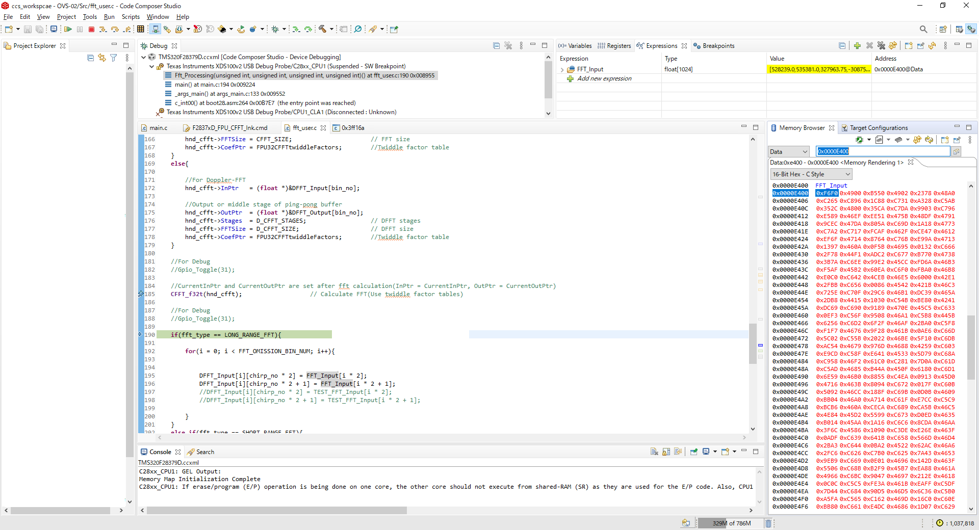

  • Thank you for your reply.
    Isn't placing the FFT_Input buffer at 0x0000E400 meant to be aligned on a 4N word boundary?
    The memory is set as follows in the linker command file.
    The value is incorrect only when the FFT_Input buffer is placed in RAMGS03.
    <F2837xD_FPU_CFFT_lnk.cmd>
    --define CFFT_ALIGNMENT = 512
    CFFT_In_data:> RAMGS1315, PAGE = 1, ALIGN = CFFT_ALIGNMENT
    ramgs03:> RAMGS03, PAGE = 1
    RAMGS03: origin = 0x00C000, length = 0x004000
    RAMGS46: origin = 0x010000, length = 0x003000
    RAMGS79: origin = 0x013000, length = 0x003000
    RAMGS1012: origin = 0x016000, length = 0x003000
    RAMGS1315: origin = 0x019000, length = 0x003000
    Thanks in advance.
  • HI,
    Isn't there a mismatch in the alignment? You have aligned for 1315 here while placing the buffer in GS03.
    Also, from your screenshot, it appears that the values themselves have changed. Have you investigated why that may be?
    Please try to stick to the template in the example linker cmd files as far as possible.
    Shanty
    Since the following is defined, I think that there is no problem with alignment.
    --define CFFT_ALIGNMENT=512
    The reason the value has changed is because I used CFFT_f32t.
    My understand is that CFFT_f32t use the buffers which set in InPtr and OutPtr as ping-pong buffers in the calculation process.
    If the FFT stage is odd, the FFT result output to the buffer set to CurrentInPtr.
    Therefore, FFT_input is changed the value.
    I set the FFT_input buffer to InPtr and CurrentInPtr.
    Thanks in advance.

  • Can you tell me what the exact error is?
    The content of the error is that the FFT result changes depending on the memory allocation.
    The image is attached in the top post, but the upper image is when there is an error and the lower image is when it is normal.
    When normal, it is the same as the FFT calculation result of Matlab.
    At the time of error, it is very different from the FFT calculation result of Matlab.
    I attach the result of my temporary analyss.
    FFT_Result_Error.xlsx
