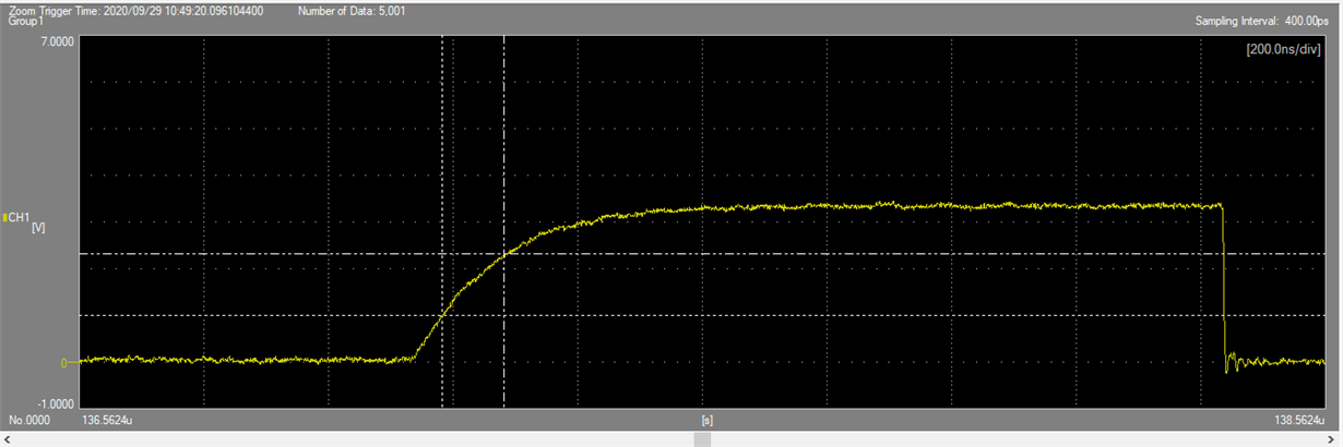

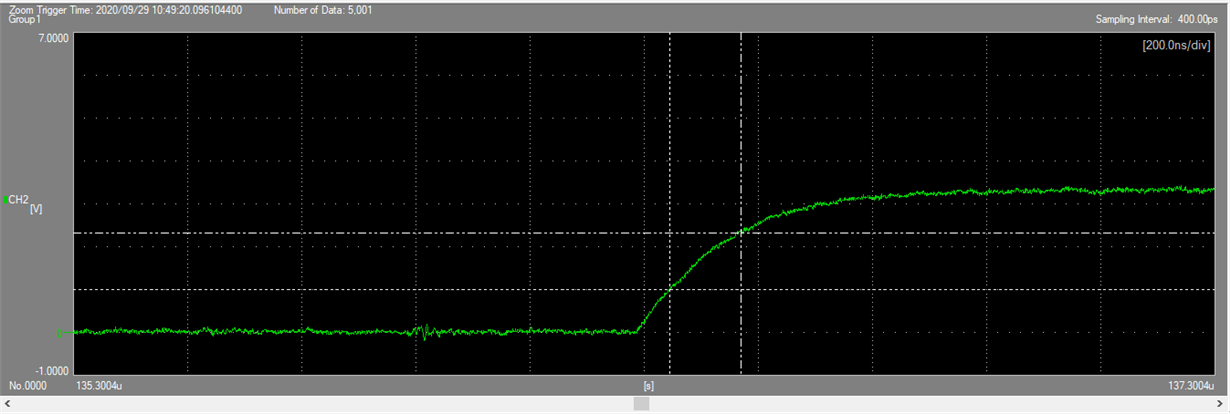

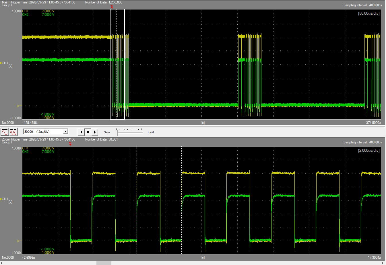

  • Hi Kevin,
    Attached you can find the following captures:
    1.- I2CA / ICCH = 6 ICCL = 8 (with the one temp unit corrected). Freq is 400 kHz and waveform seems ok:
    2.- I2CB / ICCH = 7 ICCL = 8. Configuration at it should be, CH1 is signal before adapting the levels to 0-5V and CH2 after. As you can see waveforms are ok and freq is also 400 KHz

  • Hi Kevin,
    We´ve also observed unwanted peaks on SCL and according to SPRZ422I this happens because SDA and SCL outputs are implemented with push-pull 3-state output buffers ratherthan open-drain output buffers as required by I2C.
    We´re experimenting this behaviour only in I2CB bus (which has no slaves connected from the DSP to the Buffer we use to adapt levels):
    Although it seems it won´t cause an issue on the SDA I would like to limit the current. According to SPRZ422I series termination resistor should be located near SCL and SDA terminals according to Fig7 of this document. I was wondering which Rst value is recommended in order to implement it in the desing.
    Thanks!
  • Hi Bernardo,
    Thanks for providing the waveforms, both cases look pretty clean and OK to me. The I2CA signals have longer rise times compared to the I2CB, but that shouldn't impact clocking at 400 KHz.
    If it isn't easy to add / remove slave devices on your setup I would hold off on testing with fewer slave devices. I will try and locate a board that I can test the GPIOs 42 and 43 on and get back to you with the results next week.
    Bernardo de Riva said:
    We´re experimenting this behavior only in I2CB bus (which has no slaves connected from the DSP to the Buffer we use to adapt levels):
    This might be because the I2CA lines have more resistance / capacitance on the lines with the numerous slaves connected.
