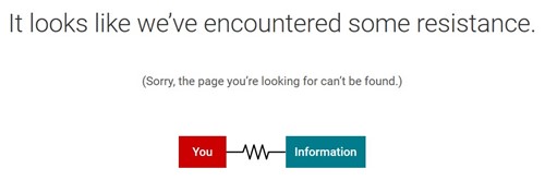

  • Hi Mathew,
    MatthewPate said:
    This link is not opening.
    Najeeb

  • Najeeb,
    I've edited that post and corrected the link.  Please try it now.
    Matthew
