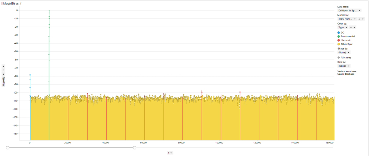

  • Hi Taeyeong,
    What is the source impedance and bandwidth of your source?  You may need to use a high bandwidth and low noise op-amp to buffer the signal for the ADC and/or you may need to increase the ADC S+H duration (set by the ACQPS setting in the SOC configuration) to get good results.
    You may or may not see the harmonics depending on the level of your noise floor and the distortion inherent in the signal and in the ADC, but you should attempt to identify them in any case.  Attached is an example spectrum of a very clean 10kHz sine being sampled by the 12-bit ADC on F28388x; the noise floor in this case needs to be pretty low to see the harmonics.
