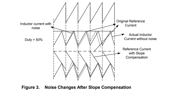

What value should I set to "RAMPMAXREF_SHDW"? In the code example it is set to "(UINT16)(1024<<6);" during the Comparator setup code. Why? Then, in the end of the Slope Compensation Code, "RAMPMAXREF_SHDW" is set to "Ref", i.e the current reference. How should the "Ref" be set? If I want a current I_ref, then I need to set the "Ref" to something higher than I_ref, so that the compensated reference goes down to my desired current Iref to meet my sampled current at the right time. Or maybe I am misunderstanding how the compensated referencing works. Could you explain?
I also do not understand why something is written to "DACVAL" at the end of the Slope Compensation Code. Isn't the DAC output automatically changed by "RAMPSTS" as the ramp is subtracting at every PWMSYNC?
  • Here is a diagram of the comparator and ramp. I think the DACSOURCE setting to 1 makes the ramp as input to the DAC. But in the code they set a value to the DACVAL. Why is the DACVAL even relevant in the code?
    Yes, the RAMPMAXREF calculation becomes complicated with the addition of slope compensation.  Fortunately, the control-loop can find the optimal RAMPMAXREF value as it seeks the desired output voltage.
    This document provides more theory behind the slope compensation scheme.  For the associated example, they used the CLA to program the DACVAL, but you will be able to use the Ramp Generator logic to control the DAC instead.
    You are correct that with the Ramp Generator active, the writes to DACVAL will have no effect on the system.

    Does it make sense to let RAMPDECVAL be the mulitplication of the reference current Ref and the slope Com_Ratio? I.e Ref*Com_Ratio, as it is in the code.
    I'm not familiar enough with the system to answer this question with confidence.  The primary purpose of the decrement slope is to guarantee that the duty cycle does not exceed 50%.  There are probably a number of different approaches that could be used to arrive at this behavior.
    In another document I found this calculation for slope calculation, but it's for a full bridge converter. 10% of the maximum current sense signal in a switching period, is that a rule of thumb that might be used? Do you think it would be possible to tweak the slope value manually until the system becomes stable?
    The theoretical slope calculations are dependent on the system topology.  This equation is probably a good starting point for its specific hardware.
    Manual tuning is certainly possible.  I think of the calculations as helping to provide a usable starting value for further evaluation on hardware.  The on-board components are not ideal so it is not uncommon to make manual adjustments.
