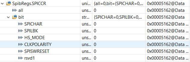

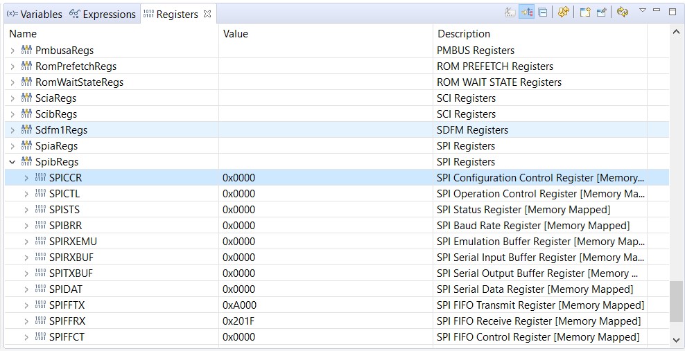

  • I apologize, you are completely right that it is GPB, it was a typo on my end in my response. In the code, I was setting and monitoring the GPB registers, and just double checked, and they are in fact being set properly. Although you mention that they should both be set to 10b, but in the manual that I am referencing it says to set the GPBGMUX to 01b and GPBMUX to 10b (resulting in the 6 I am using in the function). I am looking at http://www.ti.com/lit/ug/spruhm9f/spruhm9f.pdf on page 831, I tried looking for the document you mentioned to see if it is different but am not sure how to search for it. Are we talking about the same document or am I using an incorrect version?
    I just tried enabling the loopback and there is no change on the output side, nor does the SpibRegs.SPIRXBUF register show any signs of change, remaining at 0 for all operation, as before.

    Ok, now we are getting somewhere. The fact that you can't write to the registers indicates to me that there is no clock to the SPIB module. I do see you have the code to set PCLKCR8.SPIB = 1 which should enable the clock. However, this register is write-protected by EALLOW, so make sure you have enabled write access before writing to it.
  • I just added the EALLOW and corresponding EDIS, but there is no change at all. It is also strange, because just before this, I am enabling the clocks for ePWM, and those modules work perfectly fine (they are all on PCLKCR2). Also, in the top right most screencap in the image, even before the EALLOW it seems that the SPI signals are being turned on (which is also somewhat strange, as I am only intentionally enabling the SPI_B). Could there be some sort of overlap or something like that? I am using CpuTimers 1 and 2 for scheudling in my code, I am not sure if that could be impacting this somehow?
  • Ok, I see now that PCLKCR8.SPIB was already set.

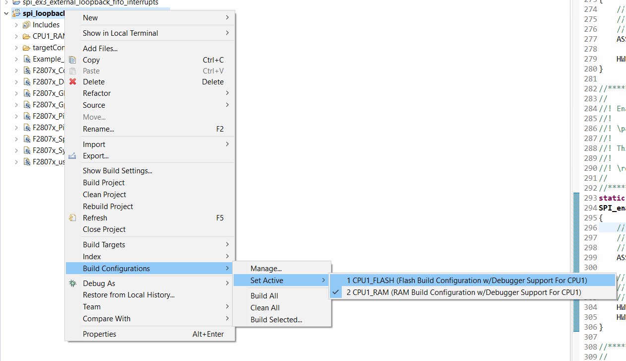

    I think the best course is to try the loopback examples. To your earlier question, you should be able to comment out the GPIO configuration code in the example and run it like that. Since internal loopback is enabled, you don't need the GPIO configuration. Alternatively, you can modify the code & GPIO configuration for SPIB use. I see the following example as a good one to try.
    C:\ti\c2000\C2000Ware_3_02_00_00\device_support\f2807x\examples\cpu1\spi_loopback\cpu01
    Are you using custom board? You may want to try setting the boot mode to "wait boot mode" just to eliminate the possibility of the ROM or any other code stored in flash from changing settings on you before you load & run the example code.

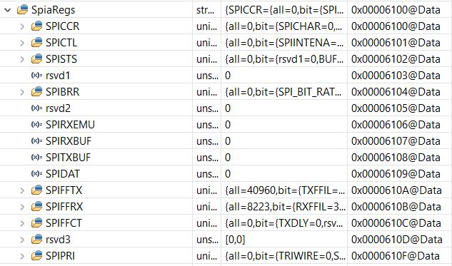

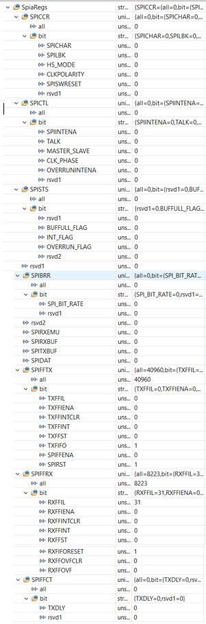

  • Hey Gus, sorry for the delay. I have just gotten the example you mentioned running, with no modifications except commenting out the line which calls InitSpiaGpio(). I tried this both on the bootmode which I have been using, as well as forcing wait boot mode, and both lead to the same exact results. I will post an image of all of the SPIa registers below, but they all appear to be uninitialized, except some strange values in some of the FIFO registers.
  • Hi Fred,
    A few questions. Did the example code return any errors? Can you verify that the CCS register window is indeed pointing to the right address? Per the device datasheet SpiaRegs start at 0x0000 6100.
  • Yes sorry for cutting out the address section of the info. It does appear to be at the correct address, though. There are no errors or warnings when building the code, either.
  • Fred,
    In the example code, does the CPU stop in error()? Have you tried a different board?

  • The InitSysPll() function is setting up the clocking scheme on your device. It could be failing for multiple reasons: no external crystal oscillator, PLL not locking due to incorrect setting, etc. It would be worth you digging into the variables passed to the function to make sure they match what you board can support (the source for the function is included in C2000ware). For now, maybe you can comment that function out. Best case, the CPU and peripherals will be running very slow, but at least we get to see something working. :-)
  • Hey Gus, thanks again for the continued support. I appreciate you sticking with me, despite some fairly novice questions.
    So after changing the InitSysPll options to match ones that I had working in my main build, I was happy to see that the spi was working as intended. By this, I mean that the Tx was properly looping back to the Rx and increment in the loop with no error. This continued to be true for Spib as well, so I went to my main build and tried to replicate everything as closely as I could to how it was set up in the example. Of course, there are other sections in between which I need to setup the other peripherals on the board, but the main components from the example are all there. Unfortunately, though, although it gets through all of the initialization and into the main control loop, it is once again not changing any of the Spi registers (neither on Spia or b), instead all remaining at 0. This time it is definitely reaching those lines of code and continuing forward.
    The only major difference that I can see between the two (other than the other additional peripherals, which to my knowledge shouldn't have any interaction here) is that I am running my main code off of flash. I am not sure if there is anything to do with this that I need to be aware of when trying to match the example code. If not, I am not sure what else could be causing me to be unable to write to the Spi registers.

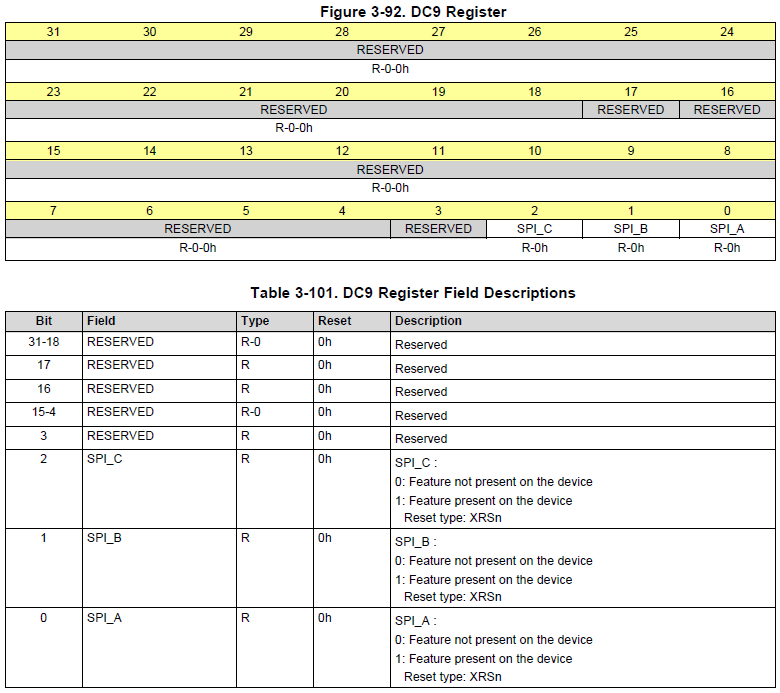

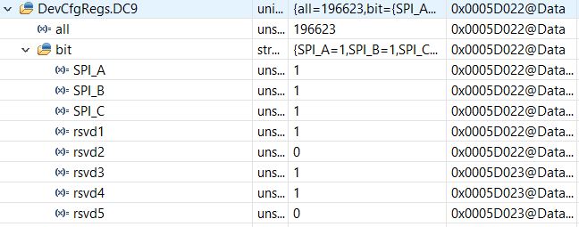

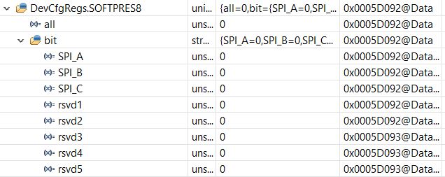

  • Hi Fred,
    Can you check the status of the SPI_A/B bits in the SOFTPRES8 register under the DevCfgRegs group in CCS? I'm wondering if the SPI modules are being held in reset. This would definitely prevent writes to the SPI registers. By default these bits should be 0 (SPI peripheral not in reset).
  • It appears that they are in fact set at 0. This is at the breakpoint just after the first line, as in my previous message. I am not sure if it matters, but these are also toggleable (I set the SPI_B bit to 1 and then back to 0, and it proceeded the same as before).

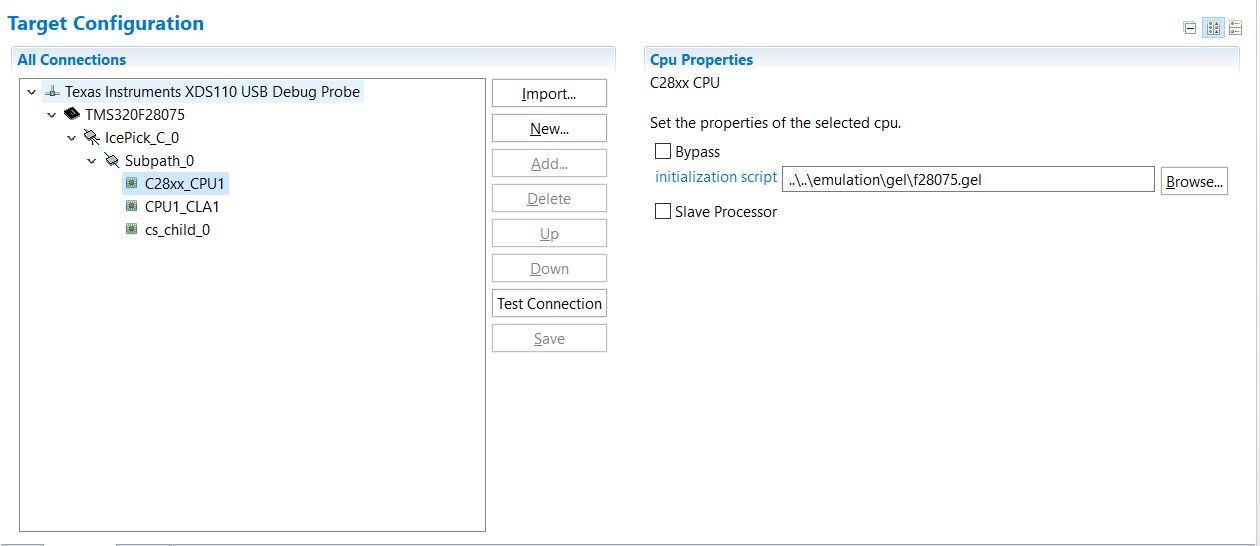

    The only thing I'm thinking is a possible difference in the GEL file??? Check which GEL file the example code uses and the one your main code uses. Are these the same? Are there any differences?
    For reference, the GEL file used in the example should be located in:
    <ccs_install_dir>\ccs\ccs_base\emulation\gel\f28075.gel
    By default the OnTargetConnect() function should run when you start the debug session. I'd start there.
  • Hey Gus,
    No need to apologize at all, I am very glad for the continued support despite the annoyance of this issue. I also apologize for the delays in getting back to you, I have had a lot of parallel things coming up, but try to get back to you as soon as I can.
    So I am a bit confused on where to find the gel file used, it is not listed as part of the build log (at least not that I could see) but if I am correct that it is the one listed below in the target configuration screen, it seems to be that it is the same one that you mentioned should be used for the example. If this is not the correct one to be looking for, if you could point me towards how to find the gel file I will gladly get you the correct information.

  • Fred,
    Regarding the GEL file, his is used by CCS to automate some functionality. You can read more about it at this link. These functions are not part of the actual executable code that runs on the MCU. These are executed by CCS directly.
    You specify the GEL file to use in the target configuration file, as you already discovered. Once you launch a debug session (i.e. launch the target config file *and* connect to the CPU core), you will see two menu options in CCS: Tools>GEL Files tells you which GEL file you are using and Scripts shows you which menu functions have been defined in your GEL file (if you read the GEL file you should see hotmenu items that correspond to these functions).
    There are some GEL functions that execute automatically. For example, OnTargetConnect() executes when you connect CCS to the target device. Among other things, this function calls several memory map functions that basically tell CCS which memory regions it is allowed to access. You may have seen a message pop up on CCS that reads "Memory Map Initialization Complete". This is the OnTargetConnect() function executing.
    So long story short, I'm interested to know if the example code target config file and your main code target config file are using different GEL files.

    1. Connect your board as you normally would and fire up CCS. Do not load your code or start the debug session just yet.
    2. In CCS hit View>Target Configurations. You should see a window that pops up with "Projects" and "User Defined" target configs. Find the target config for your project (should be under "Projects"), right-click and launch. You should see the Debug perspective launch.
    3. Under "Debug", right-click on the  CPU and select "Connect to Target". CCS should now be connected to your board.
    4. Now we add the poltergeist catcher script to your GEL file. In CCS, go to Tools>GEL Files, then double-click on the f28075.gel from the "GEL Files" window to open and edit it. You can add the lines of code to the end of the file. Save the file.
    5. You can now "reload" the GEL file by right-clicking on the file in the "GEL Files" window.
    6. Now you can run the script. In CCS, select Scripts>Poltergeist Catcher>SpibTest. You will see the GEL output on the Console. Let me know what that says.

    C28xx_CPU1: GEL Output: CpuSysRegs.PCLKCR8: 0x0x00000000
    C28xx_CPU1: GEL Output: DevCfgRegs.SOFTPRES8: 0x0x00000000
    C28xx_CPU1: GEL Output: SPIBRegs.SPICCR: 0x0x00000000
    C28xx_CPU1: GEL Output: CpuSysRegs.PCLKCR8: 0x0x00000002
    C28xx_CPU1: GEL Output: SPIBRegs.SPICCR: 0x0x000000F7
    C28xx_CPU1: GEL Output: ...SPIB Test End

    So I ran your script in 3 separate locations, first as per your instructions, then at the entrance to main, and then at a hardware breakpoint just after InitSysCtrl() and nothing else. If I am not mistaken, it seems that all 3 have the correct outputs, with the third being slightly different due to the SpiA, B, and C bits of the peripheral clock being set to 1 in the InitSysCtrl call.
    As per gus instructions:
    SPIB Test Start...
    At main start:
    SPIB Test Start...
    After InitSysCntrl:
    SPIB Test Start...
    C28xx_CPU1: GEL Output: CpuSysRegs.PCLKCR8: 0x0x00000007
    But what I was more surprised to see is that even after these, when looking at the registers through the debugger, the SpiB registers didn't change at all (image below was taken after InitSysCtrl and then running the script, but the same exact thing happens when I stop at entrance to main and run the script). Not only do the registers not show any change, I also am still unable to manually change them, either, even though it appears from your script that they should in fact be changing.
  • Well, 0x0000 5162 is not the right address for SpibRegs.SPICCR, so that's why that's not matching the GEL output. I think before you had checked the SpiaRegs address and that looked ok, but I wonder if this was always the problem for SpibRegs?

  • Fred,
    Can you check the contents of DevCfgRegs.DC9 to makes sure that the SPI is not locked out?
    -Tommy
  • You are right, I was pulling all of my previous screenshots from the expressions tab, which up until now has never given me issues. I just checked in the registers window, and it does in fact change when I run your script! Weirdly enough though, even in this window, nothing changes when I run the initialization code which is supposed to change the various spi registers. I can, though, change it manually through the registers window. I tried to manually change all of the values in order to get them to what they would be if the initialization code went through, and then manually changed the SPITXBUF to try to send a value, and it still did not appear to do anything when I scoped the output.
  • Hey Tommy,
    It does appear that these registers correspond to the SPI working. This screenshot is taken from the expressions menu, though, which as per the previous couple of messages seems like it may be an issue?
    This is weird. To be honest, I'm not 100% sure how the register map gets populated by CCS, but I think as long as your target config is setup correctly this should work fine. Maybe double check the target config file for your project OR use the one that comes with the example code you ran earlier and worked (assuming they are different).
    This makes me believe your code is not building or linking the right header files. Maybe your code is writing to the wrong register addresses. You should be able to tell by browsing the disassembly window as you step through the SPI init code. Or, maybe easier, you can also review the .map file for your project to see where the SpibRegs are getting linked to.
    You probably need to set the FREE bit in the SPIPRI register to allow the SPI to operate even when the emulator has halted the processor.
  • Hey Gus,
    Sorry for the delay. I had an issue come up that unfortunately took precedence and only got a chance to come back to this today. So I checked out the .map file and it does in fact look like it is not reflective of the values listed in the user manual. I have no idea how this happened, and also am not really sure of the fix.
    If I am reading both of these correctly, then it appears from the manual SpiRegs should start at 6100
    SpiaRegs SPI_REGS 0x0000 6100 0x0000 610F Yes Yes Yes
    SpibRegs SPI_REGS 0x0000 6110 0x0000 611F Yes Yes Yes
    SpicRegs SPI_REGS 0x0000 6120 0x0000 612F Yes Yes Yes
    And from the manual it appears they are being set to start at 5122
    1 00005122 _SpiaRegs
    1 00005162 _SpibRegs
    1 000051a2 _SpicRegs
    Is the fix for this to update the .map file to a correct one or would the change have to come from somewhere else? And if it is the .map file, could I just take the one from the example and use that?
