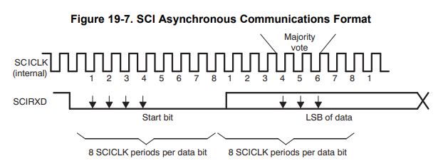

    There is still possibility of collision/corruption -if- the data received is actually unreadable according to the receiver signal format of a frame. Basically stated, if the C2000 receives byte/frames that do not have proper timing for the bits to be determined as 1/0, then corruption of the frame can occur. The image below from section 19.10 of the TRM shows how our device strobes each bit and determines the 1/0 state, as well as the start bit detection:
    So unfortunately, considering the application mentioned here is approaching the upper baud-rate limits of the device, the speed of the program will likely require an idle-time of 10 bits as mentioned in the TRM.
