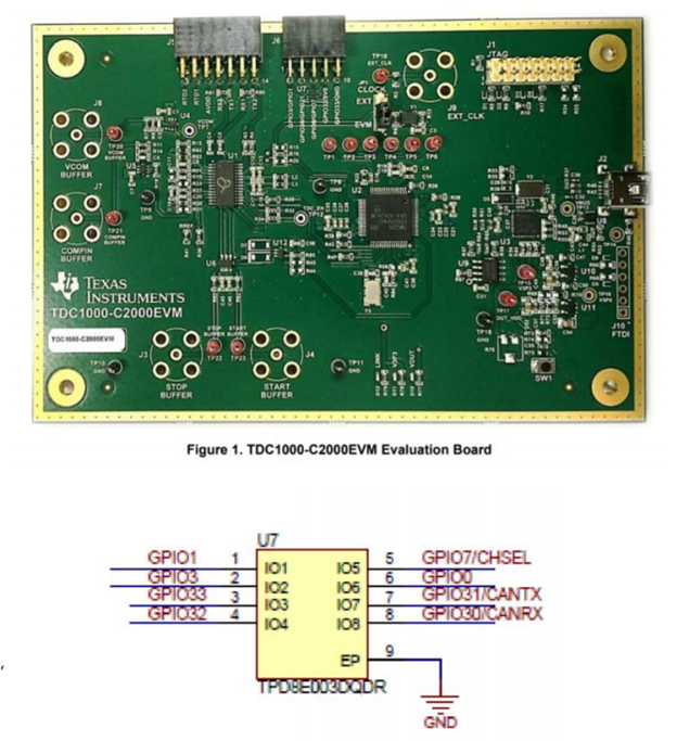

I have been working with the TDC1000-C2000EVM for some time now and have been trouble editing the firmware of the TMS320F28035 microcontroller to get it what I want it to do. There is a transducer that the TDC1000 is connected to to read the Time of flight it takes for the signal to be sent and received. It can be used to measure liquid level or liquid Identification. The point is, I am trying to write this value onto an arduino and read it in the serial monitor of the arduino.
I am limited to the types of communication on the board for there are only 8 GPIOs I can hook up to directly. There are several GPIOs in the microcontroller but to connect to these I would need to design my own board or solder to that pin directly which is near impossible. I found a project similar to mine but he used the TDC1000-TDC7200 and he only made 2 small changes to the firmware:
https://e2e.ti.com/support/sensors/f/1023/t/720185?CCS-TDC1000-TDC7200EVM-Using-the-board-regardless-GUI
TI does not support this board anymore and I assume the TDC1000-C2000 is the new board that they use. He mentions that he edited 'TDC1000_Uart_stream = 1' (instead of 0) so that Uart stream is the default mode of communication. I could not find this anywhere in the firmware but was able to edit 'tof_graph_state = 1' to make the tof continuously read.
So just by simply connecting to a GPIO that utilizes UART  and making these two changes he was able to read these values in the serial monitor of his arduino. The only options for communication I have are PWM, I2C, and CAN TX (via a connector). My best option seems to be I2C but would still like to use UART if possible. If I was to go with the I2C route, I would need to connect to GPIO32 for SDA and GPIO33 for SCL. GPIO0, 1, 3, and 7 used PWM and GPIO31 use CANTX. So this is what I am limited to.
Below is the main_level_tdc1000 firmware code. If anyone can help edit the firmware code to get it to what I would like it to do, it would be much appreciated. for I do not have mcuh experiance in C code.

  • Lori,
    The 8 GPIOs that I can connect to directly via U7 is shown below.
    These are the specific outputs they can be set to.
    GPIO0 - ePWM1 output A output
    GPIO1 - ePWM1 output B output
    GPIO3 - ePWM2 output B output
    GPIO7 - ePWM4 output B output
    GPIO30 - no output available
    GPIO31 - CANTXA - eCAN-A transmit output
    GPIO32 - CANTXA - ADC start-of-conversion B output or SDAA - I 2C data open drain bidirectional port (I/O)
    GPIO33 - CANTXA - ADC start-of-conversion B output or SCLA - I 2C clock open drain bidirectional port (I/O)
    I am trying to connect one of these to my arduino to see the value change in real time on the serial monitor capability of the arduino. I understand editing the code to toggle, enable pullup and configure the GPIOs to either an input or output. I am confused as to what values are being outputted whey they are set to outputs. I have not been able to find anywhere what these values relate to. I thought at first it was the TOF (Time of flight value) but have not been able to prove that. The TOF is the value I would like to output/ write to the arduino.
    Another question is which form of communication (which GPIO) would be the most ideal to connect to? I was thinking possibly the I2C.
    Colin
  • Picture did not upload above of U7 connection so here it is
