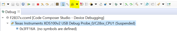

    4) Instead of clicking the 'debug' button go to your target configurations by going to View -> Target Configurations within CCS
    • If you don't already have one for F2837xD then create a target configuration by right clicking under the 'User Defined' folder of the 'Target Configurations' window and selecting 'New Target Configuration'
    • Once you have a designated F2837xD target configuration that successfully connects to the device, right-click on the .ccxml file and select 'Launch Selected Configuration'
    • In the debug view you should see the C28xx_CPU1, CPU1_CLA, C28xx_CPU2, and CPU2_CLA. Right-click on C28xx_CPU1 and select 'Connect Target'. Do the same for C28xx_CPU2.
    • Next step is to load the project files. Click on CPU1, the find the load option. Below is a picture for help. Select the arrow next to the load icon and choose 'Load Program'. Select the .out file for the CPU1 project. This should be located within your workspace: workspaceX\blinky_dc_cpu01\CPU1_RAM_DEBUG. Do the same for CPU2.
    5) Once the projects have been loaded to both cores you should be able to run the projects and see the timer increment in the expressions window.
