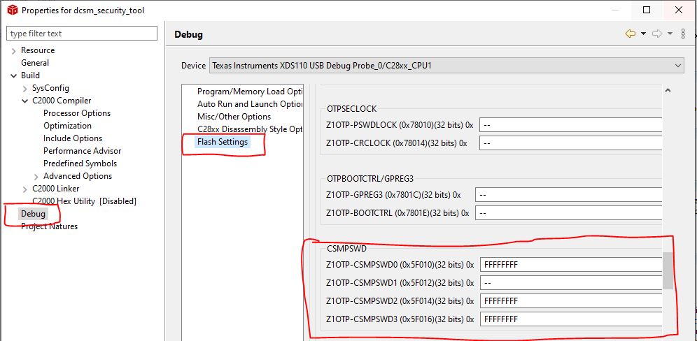

  • In that case you should be able to open the project property (right click on project in CCS and select "Properties") and select Flash setting under Debug. In this GUI you can provide the password and click on Apply -> Apply and Close.
    Now when you launch the debug session it should be able to unlock the zone using password provided before flashing new program. Please try this and let me know if you still face some issue.

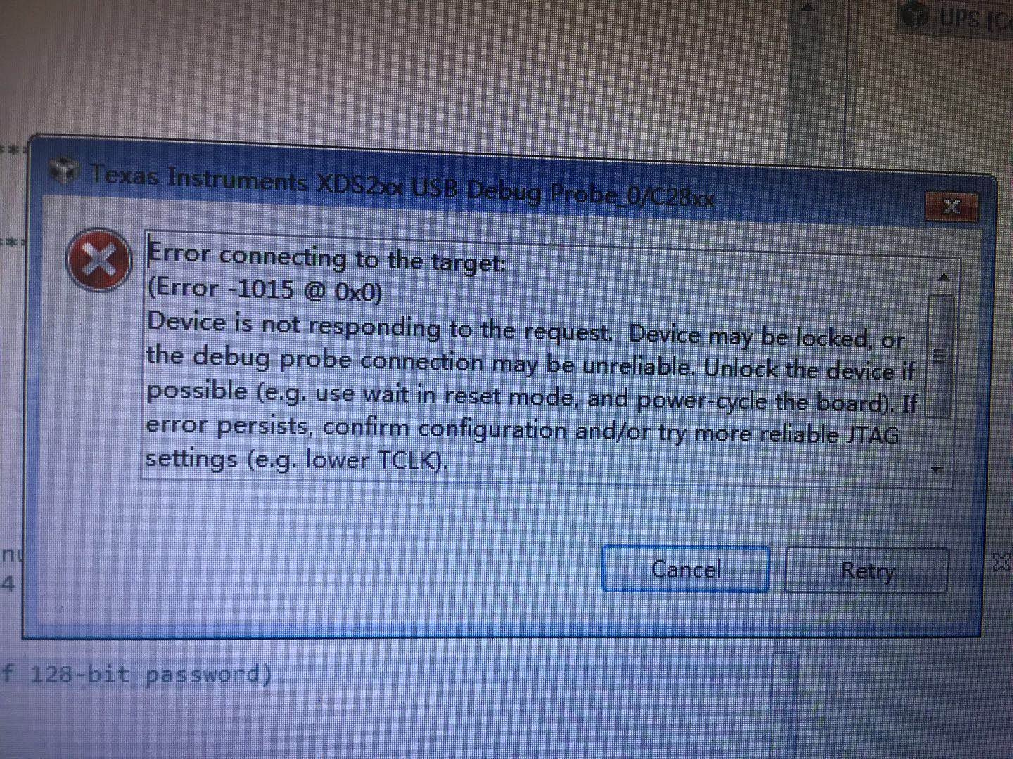

  • Hi Vivek,
    After try the above method, there's still a issue as below. However, there's no such issue when customer uses CCS3.
    Is there any other precaution to unlock the chip? Thanks!

  • Hi Vivek,
    Yes, customer use CCS3 with XDS510 emulator could unlock the same device. When use CCS8 with XDS200 emulator, the device could not be unlocked.
    Now, the .ccxml file could be connected, but after put the passwords to click "unlock" button, it shows "Target is not connected or does not support current Flash operation.". And I could also repeat this error, by click the "unlock" button in CCS8/CCS10.
    Could you repeat the error or tell us how to solve the error to unlock and program the device? Thanks!

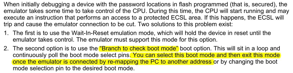

  • Hi Vivek,
    The below figure is from F28035 TRM.
    I'm quite confused now. I try to analyze the about the figure content as below, and could you please correct me, if there's any mistake? Thanks!
    1. For the first point, " use the Wait-In-Reset emulation mode", it seems to require a emulator which support "Wait-In-Reset" mode, not changing the hardware boot pin state to "Wait mode", right? If so, maybe XDS510 could support this mode, but XDS100/200 could not, I guess it from the test result.
    2. For the second point, " use the “Branch to check boot mode” boot option", there's two ways, one is "You can select this boot mode and then exit this mode once the emulator is connected by re-mapping the PC to another address"(the software way?), the other is "by changing the boot mode selection pin to the desired boot mode."(the hardware way?). If the first way uses software method, could you provide some code snippet/configuration figure? Thanks!
    Best Regards
    Rayna

  • Rayna,
    "Wait in Reset" is not working on CCS and we suspecting a CCS software bug which needs to be fixed. This bug fix will rolled-out in subsequent CCS release. I unfortunately don't have a timeline when this will be fixed.
    I don't see how you can connect to the device using software method. Your realistic option is using hardware method:-
    1) Hold the device in reset (pull XRSn low) and try connecting the device. CCS will report device is held in reset. Press retry and release device from reset. This will connect you to the device after which you can unlock using password
    2) Change the boot mode pins settings to either parallel boot / SCI boot. This will prevent the ECSL from tripping the JTAG connection. Once connected you can unlock the device using password.

  • Rayna,
    And from your answer, I guess that ""Wait in Reset" is not working on CCS " may be ""Wait in Reset" is not working on emulator", right?
    Yes, that's correct
    "2) Change the boot mode pins settings to either parallel boot / SCI boot. This will prevent the ECSL from tripping the JTAG connection. Once connected you can unlock the device using password."
    --> Just confused that according F2803x/F280049 TRM, it seems the boot mode pin should set to "wait mode". Just want to double check with you. Thanks!
    F2803x and F280049 are two different devices. Also, boot mode pins selection logic is completely different from each other. So, please stick to F280049 TRM and don't get confused by what information you find in F2803x.
    Assuming, you haven't change the default boot mode pin option, Table 4-3 Device Default Boot Modes available in Pg 591 in TRM is what you need to use. Yes, you need can use SCI boot / Wait boot (GPIO24: 0, GPIO32: 1) (or) Parallel boot (GPIO24: 0, GPIO32: 0). This will hold the device in an infinite loop without accessing flash. This way ECSL logic will not trip JTAG connection allowing you to connect to the device. Then you can unlock the device and do what you want.
