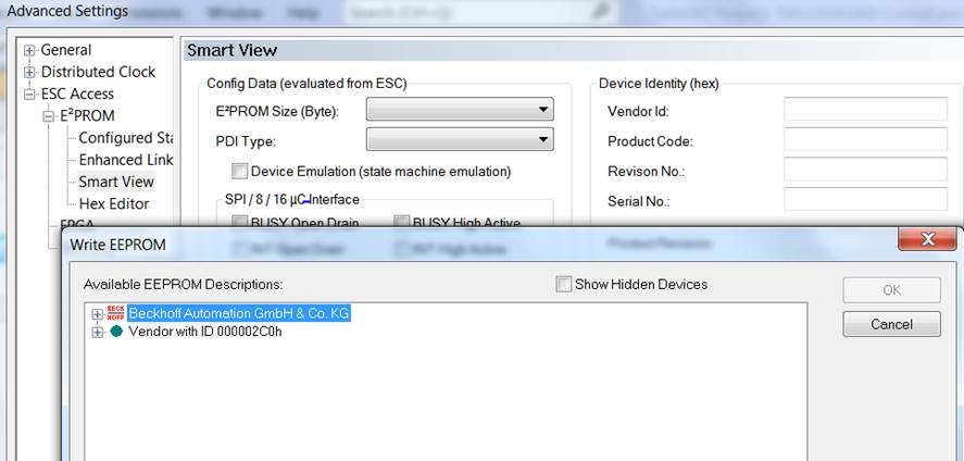

I am trying out my new ControlCard running EtherAT withTwinCAT, following the 'USER’S GUIDE EtherCAT Slave Controller Software'.
I got stuck on section 4.4 Step 6 (as following capture). I am running Cpu1_echoback example:
There is no 'Texas Instruments Incorporated' menu in the 'Available EEPROM Descriptions window'.
Please help point out what I did wrong.
