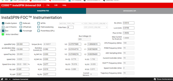

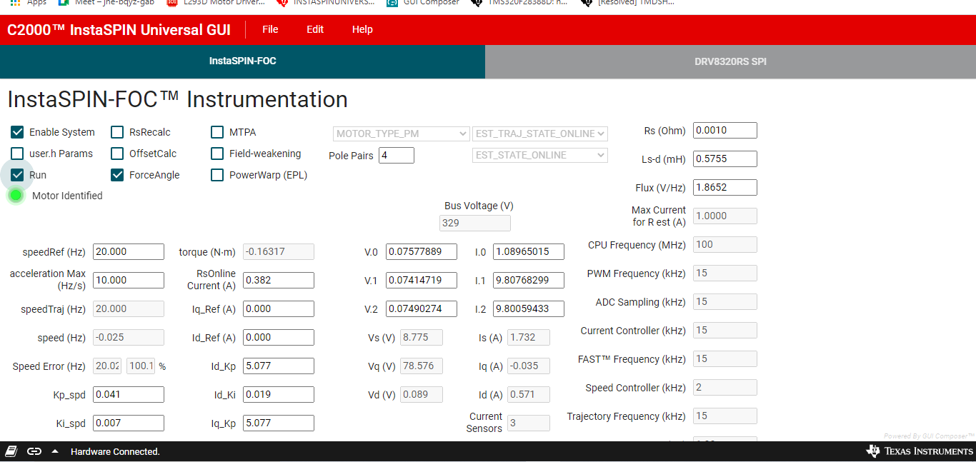

    Step 2: In "C2000Ware_MotorControlSDK_InstaSPIN_GUI: app prog.out file is loaded; after loading  .out file we observe that LED(D3) on control card is starts blinking.
    In the following screen (Instaspin FOC Instrumentation): "Motor identified" is highlighted &
    DCBUS voltage is shown as 0V (though HVKIT AC is off and we click enable system on GUI).
    Step 3: Now
    AC to HVKIT is turned on.  DCBUS voltage is shown as 330V.
    Observations: On RUN, motor doesn't respond. We measured Motor Winding's resistance = 2.2ohms (as per data sheet)
    1. We followed "quick start guide" instructions line by line for Jumper settings of HV Kit, Control card and 180-100 adapter.
    2. We followed "GUI guide"
    3.
    We followed "Lab guide" instructions line by line for is07_speed_control .
    Observations: We also changed HVPMSMMTR parameters  like Max Current to 6A, Start current to 9A. But Motor still doesn't rotate.
    Where shall I focus my debugging?
    thank you
  • You might run the lab with CCS to make sure that the motor can spin well first, and then use GUI to run it as you mentioned above.
    Looks like the DC bus voltage is too low in the GUI above, please check if the DC power supply is applied to the kit correctly.

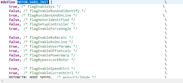

    I am able to configure and control the Motor using Lab 1 to 5, PC Based GUI by enabling System and Run button. Once the motor is identified the run button unchecked automatically. To run the motor, I am forced to recheck the Run button again.
    Now I plan to control the motor, but without using “PC based GUI” / click Run button etc. I already completed the below 4 steps. My question is: Will it help if I enable “motorvars. flagRunIdentOnline” flag again to run the motor? If yes, how to enable the same? Or am I missing any other steps than mentioned below?
    1. I go to structure volatile MOTOR_Vars_t motorVars = MOTOR_VARS_INIT; in ccs and I put the flagenable sys=true,and I change the runandonline falg=true as shown below.
    2. I flash the code in control card, i add the java script file to watch window, I enabled the real time debugger in ccs. I get the below result in watch window.
    3. The code stats identifying the motor and motor identified flag is set (watch window as below)
    4.I did the above steps by putting the code in flash lib.
    thank you

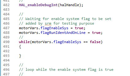

  • Add the following codes before the "while(motorVars.flagEnableSys == false)" in main file.
    motorVars.flagEnableSys = true;
    motorVars.flagRunIdentAndOnLine = true;

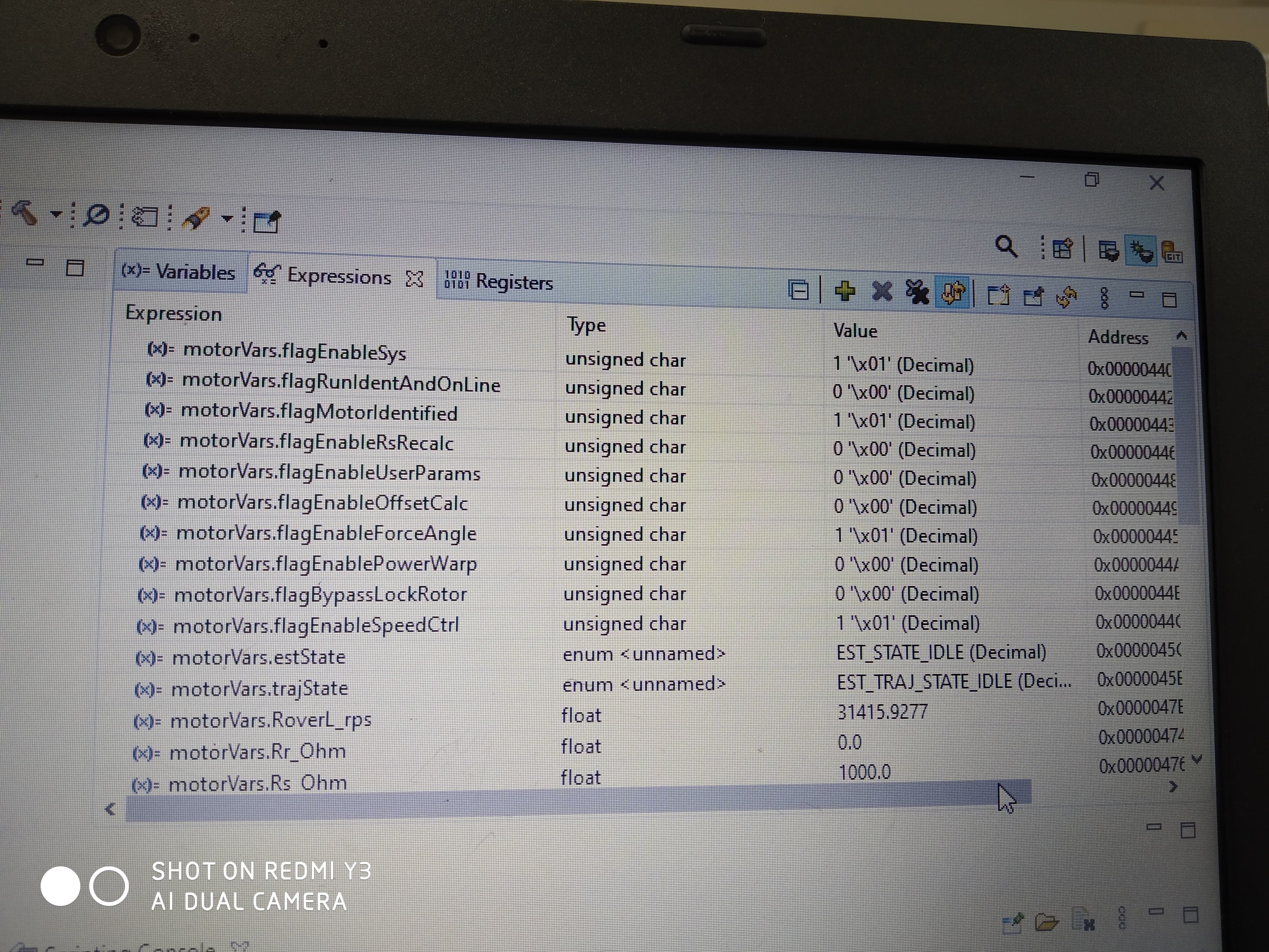

  • Hi thanks for the reply
    Step1:  I added the below code lines in main file
    Step 2:  “ motorVars.flagEnableSys = true   , motorVars.flagRunIdentAndOnLine = true “; shown in below image
    Observation: AC is on, Motor connected, but Motor is not spinning. From the GUI (Screen shots as below / attached) - It looks it is waiting for ‘Run’ button ‘click equivalent’….
    Trial: So I tried to set in code
    motorVars.flagRunIdentAndOnLine=true
    What else is missing in my sequence?
  • Please use lab07 with the identified motor parameters by lab05 to spin the motor.
    It seems like you didn't apply the bus power supply on the kit.

    We made the following modifications, to get the motor running without user interaction (or GUI) and from internal flash of controller. Please review these steps and confirm. After your confirmation, we will test it on the real hardware.
    1. Before entering the first while(), we have set the following two flags and initialized one new 16-bit counter, before starting the initial motor identification process:
      1. a.      motorVars.flagEnableSys= true;
      2. motorVars.flagRunIdentAndOnLine = true;
    2. When “motorVars.flagMotIdentified == true” condition is true, we start incrementing the 16-bit counter. The time base is taken from the 1ms Time Base (tick).
    3. After this 10sec (10000 x 1ms) delay, again we set the “motorVars.flagRunIdentAndOnLine = true” to continue the motor running.
     The code changes are given below. After your confirmation, we will test it on the target hardware (with motor connected and the AC supply given). We will flash it in the controller and run in a standalone mode. Are these modifications correct to safely test with our HV Kit again?
       gu16TickCounter = 0;
       // loop while the enable system flag is true
       while(motorVars.flagEnableSys == true)
           // 1ms time base
            if(HAL_getTimerStatus(halHandle, HAL_CPU_TIMER1))
              motorVars.timerCnt_1ms++;
               HAL_clearTimerFlag(halHandle, HAL_CPU_TIMER1);
               if (motorVars.flagMotorIdentified == true)
                   if (gu16TickCounter > 10000)
                   else
                       gu16TickCounter++;
    thank you
  • That's fine. Go ahead.
