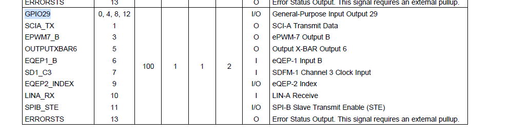

My customer want to use ECAP1 for APWM, they firstly connect the APWM signal to CLB, in CLB they will do cycle by cycle control, then they will output the CLB signal on GPIO pin, but they find that the output signal are still the APWM signal from ECAP module, not the CLB output signal. It seem there is no problem for their configuration.

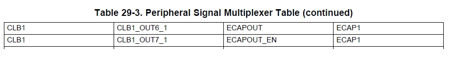

in TRM Ver.C, CLB1_OUT6_1 are mux with ECAPOUT.
but in TRM Ver.D it have been modified as below:
unfortunately customer did the schematic design according to  TRM Ver.C, why would have this change? any workaround solution for customer's below requirement  without changing hardware?
The pin they use are GPIO29, GPIO30, they will use ECAP1, ECAP2 to generate APWM, send APWM signal to CLB, then in CLB do some logic control, at last the CLB output will be connected to GPIO29, GPIO30.
