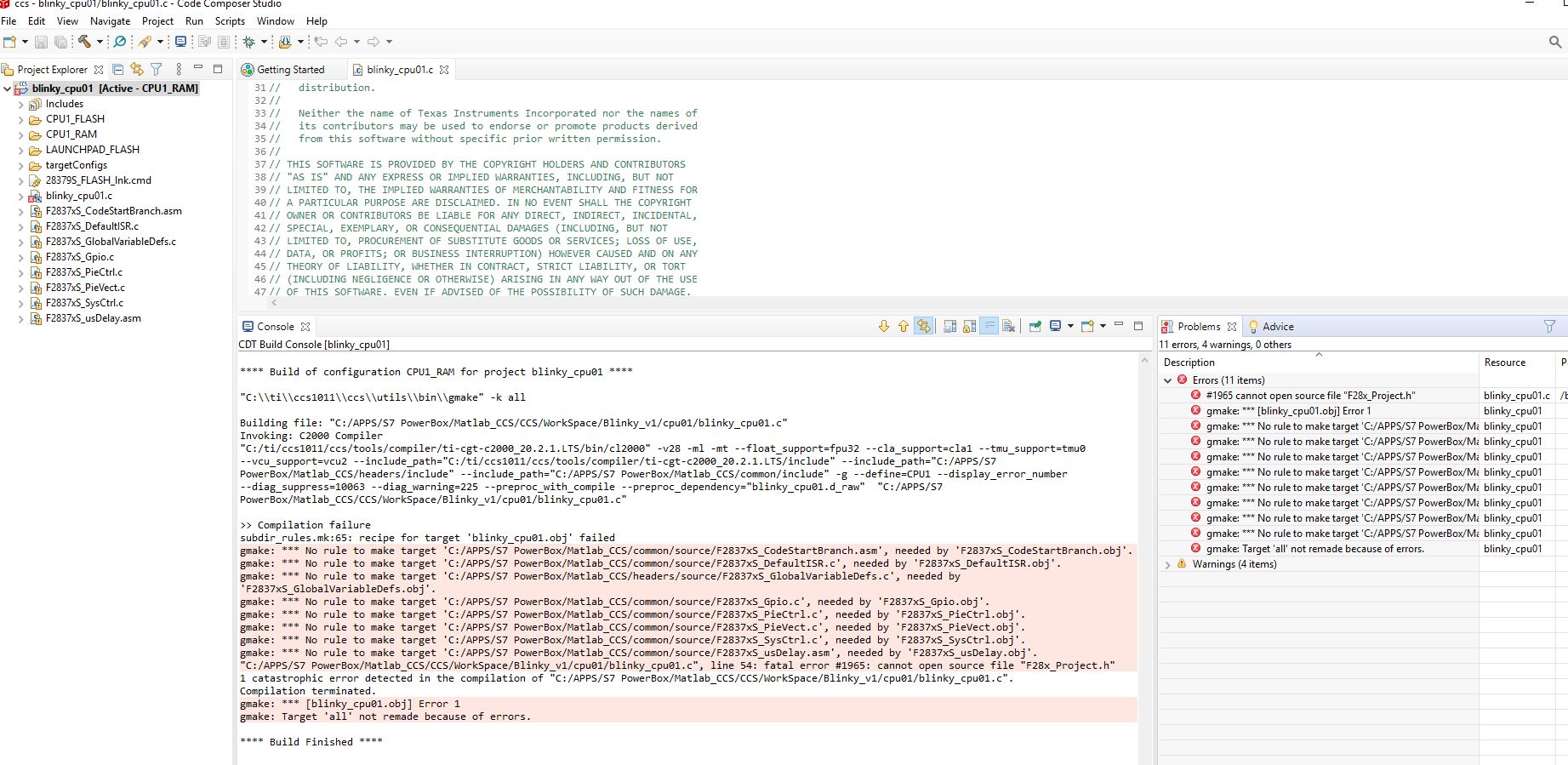

  • Hi Santosh,
    I did a CCS update over the w/e and the pc crashed so I had to reinstall CCS!
    Before it crashed removed the ther underscore in usDelay but it still wouldnt compile, but not sure how this change would affect this Flash loading?
    After the install im now getting the following errors?
  • Ian,
    Can you reimport the project and compile? Looks like some of the paths are not set properly.

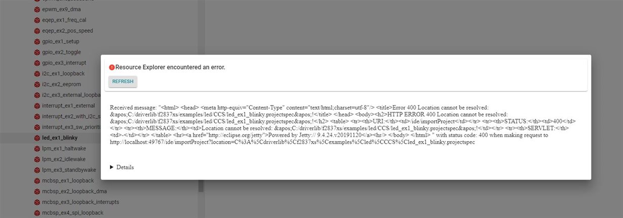

  • Hi Santosh, Im now having problems loading any of the example projects. This is for any device. See error below:-
    Any ideas?
  • Ian,
    Looks like step in backward direction. Earlier you mentioned that you are able to build for RAM configuration and it fails to build for Flash. Now you cannot load using resource explorer.
    Looks like it is known issue. For now,  you can directly import the projects into CCS using the "Project->Import CCS Projects-> Select the directory within the installed version of C2000Ware"
    There is another thread, the issue is being tracked. Here is the link:
    e2e.ti.com/.../957565
  • Hi Santosh,
    Yes a big backwards step!
    I've already tried using the "Project->Import CCS Projects-> and I just get "metadata errors" for any example.
    Have tried a repair and same result.
    Wil try a fresh install...

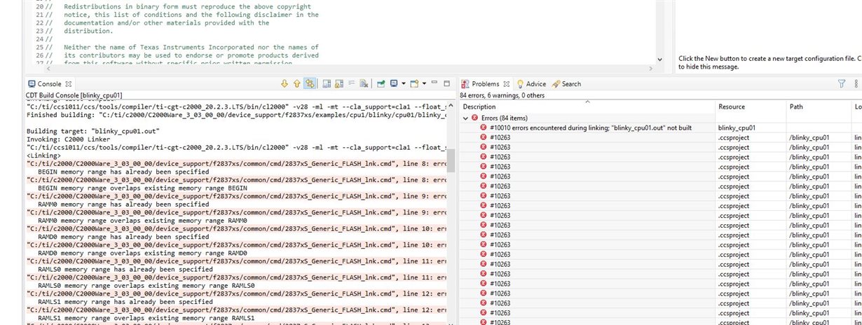

    So I can now build again with no errors if I set the build config to active => RAM.
    But If I set the build config to active => FLASH I get the following compile errors.
    Do I have some compile settings incorrectly set or am I missing some files:-
  • Ian,
    In your project on the left side (Project explorer), I see  2837xS_Generic_FLASH_lnk.cmd. Did you add it manually?
    Please delete that and rebuild it again. The project should pick the linker command file from following location automatically: C:/ti/c2000/C2000Ware_3_03_00_00/device_support/f2837xs/headers/cmd
  • Hi Santosh,
    No havent added this file?
    Ive deleted it now and the Flash version now build with no errors..
    I then try to download the .out file to my target and I get :-
    This is the same for a RAM build.

  • Hi Santosh,
    Looks like when I imported the example Blinky it didnt import all the files.
    If I explore to where the example are the main_cpu01.c is correct.
    For what ever reason Iam not able to import the examples.

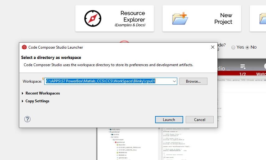

    If I try with project/import cs projects. I get...:-
    Can you give me instructions how to create a new workspace in new folder so I can import an example, like led_blinky.
  • Ian,
    Go to CCS menu File -> Switch Workspace, select Other and browse to new folder location where you want to create the workspace.
    What is CCS version and C2000ware version you are using?

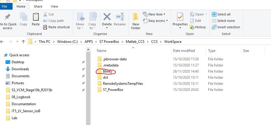

    Firstly Ive copied the Blinky example from the Ti/C2000ware dir to a new dir:-
    So
    Next I select the workspace with switch workspace:-
    Next, workspace is now opened and new project explorer tab appears:-
    Next, go to file open projects/files and point to Blinky project/cpu01:-
    Next, NO projects appear?????

  • Ian,
    Looks like again there was issue in importing your project. The include path is not imported correctly. It should be something like below.
    I will strongly recommend you to go through the workshop. It will help you a lot.
  • Hi Santosh,
    for some reason the imported project file paths are incorrect and it has created C:\APPS\S7 PowerBox\Matlab_CCS\common and C:\APPS\S7 PowerBox\Matlab_CCS\headers that dont exist:-
    This is the correct path but cant see how to change it:-

    So back to the C2000ware examples and CCS. I think I've worked out the compile issues. I've reloaded C2000ware_3.03.00.00 and I'm able to load several projects incl blinky and compile without issues.
    Note the configuration is set for "Flash" also the variant is set for "Generic C28xx":-
    This compiles as you can see with no issues but when I try to load my board I get the following message:-
    Not sure what the issue is here but I think its saying its detecting a F2837xD (dual core) device, but the device part number on my board is definitely  F28379S? So maybe this is smthg to do with the Variant build setting being set to "Generic C28xx". So If I set the Variant build setting to exactly the correct part ie. F28379S then the code wont compile, see below:-
    Interesting thing is now it doesn't seem to be possible to go back to the Generic Variant build setting and get teh code to compile again and I just get the same error  as above. I have noticed that onece you go back to the generic variant the comiler version has changed, see below:-
    So it seems once you try and compile with the device set to the correct part variant and it fails to compile, some others files get changed and to be able to successfully compile with the Generic variant option again you have to completely re-install al of the Blinky project files.
    Any ideas what is going on?
    Ian
