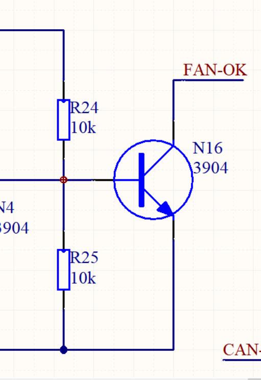

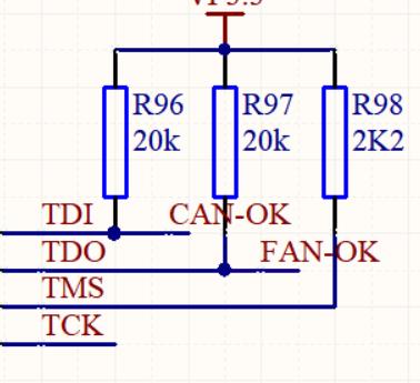

Customer is considering to use TDO as GPIO in the following way.
Will this influence jtag connection?

This will be fine to use TDO as a GPIO. A scan sequence on the TMS pin is required to bring the JTAG out of reset, until that happens TDO will not be needed. In addition, on this device we support 2 pin advance cJTAG, that only uses TMS and TCK pins; if customer uses this mode, then TDO nor TDI will not be needed even for JTAG connection.
