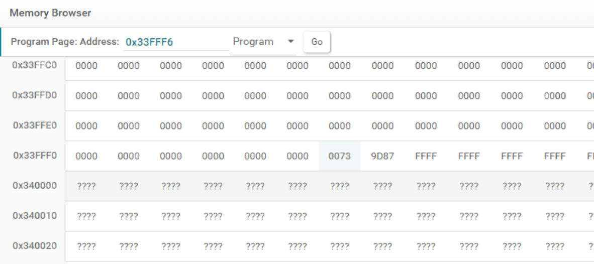

Designed a custom bootloader for F28335 board, I am storing my custom bootloader in Section A (0X338000) and application code in Sector B-H.
I am toggling a GPIO in Custom bootloader code, to notify me when the control reaches my Custom bootloader.
But I am failing to jump to custom bootloader.  Attached is my boot28.asm file.
Any idea what could have gone wrong?
Appreciate any quick replies,
Thanks in advance
boot28.asm
  • Chandana,
    1.  Did you check whether your custom bootloader is executing fine or not?
        Maybe you can toggle a GPIO in your custom loader entry and before exit - to make sure it is executing as intended.
    2. Did you verify the jump of control from boot loader to application with debugger connected?
    3. Please check if there is any reset happening (check XRSn) that is preventing the boot/application execution?
    4. Hope you confirmed that the boot mode GPIOs are properly configured for it to boot to flash where your boot loader exists.
    Note: I did not review your code.
    Thanks and regards,
    Vamsi

  • Hi Vamsi,
    thank you for the quick response.
    Below is my response
    Vamsi Gudivada said:
    Chandana,
    Thank you for the info.
    #3. Yes, you can monitor XRSn pin.
    I did probe this pin, it was high.
    #4. Do you have external pull-ups on the boot mode pins as per Table 2-3. Boot Mode Selection (TRM) flash boot?
    the pins are not externally pulled up, they are routed to one more IC(CPLD), but we are not uisng them, in the current code, we have kept them as reserved. I probed the GPIOs as well, all of them are high, (Jump to Flash ).
    Thanks and regards,
    Vamsi
    adding to above comments when I checked memory location 0x33 FFF6 [ this is where the bootloader ends up when it boots to flash according to technical ref manual] it read as below.
    the value in the location 0x33 FFF6 should be my custom bootloader location(0x338000) isn't it?
  • Chandana,
    Thank you for the update.
    At that address, there should be a branch instruction to your boot loader.
    Please take a look at this post: https://e2e.ti.com/support/microcontrollers/c2000/f/171/t/875932
