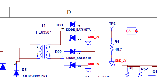

TIDM-02000 Full bridge Converter current sensing
Other Parts Discussed in Thread: TIDM-02000
I am trying to understand the circuit of TIDM-02000, https://www.ti.com/tool/TIDM-02000, specifically the current measurement that is shown in the figure. How is an appropriate R1 calculated? And won't the diode forward voltages have a large impact on the current measurement? The circuit is used for primary side measurement of the circuit. The transformer has a winding ratio of 100 according to the datasheet.
