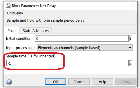

  • Hi Kevin,
    Here is the screenshot of time config for the entire Simulink model:
    Here is the Unit Delay time config:
    And here is the eQEP block:

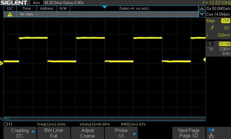

  • I ran the test again using the board's PWM channel to make sure I'm getting consistent frequency input. Below is the PWM waveform generated by the GPIO0 (ePWM1-A):
    But the result of QPOSCNT after post processing is jumping between 10 and 20:
    If I want to read 12.6Hz as the input frequency, the output of absolute block should be 1.26 but the QPOSCNT data type is always integer, so it makes sense why I don't see the right frequency.
    I changed the position counter datatype to single and double but did not see any value output other than integer. Am I supposed to see non-integer value?

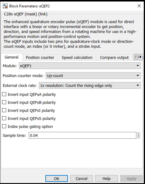

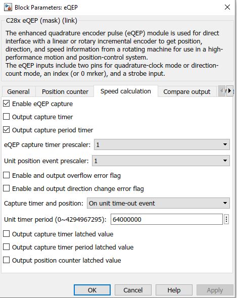

  • Hi Kash,
    I quickly setup 2 ePWM modules to generates the quadrature output and used the same as input eQEP module.
    The input frequency is 24Hz. Please find the attached snap.
    Since I had access only to F28379D launchpad board, I used the same for this experiment. However, the results would be same on any other controller that we support. I then tried to configure the eQEP block as below:
    Since the input frequency is 24Hz, it made sense to read the count at 1/24 = 0.04 step time.
    Next the configuration for Position counter:
    Finally under the Speed calculation I set the 'Unit timer period' to 64000000.
    i.e with 200MHz sys clock which is true for F28379D, it would take 0.3200 for Unit timer period to rollover.
    And with 0.04 time for one count(24Hz) we would then get a count of 0.3200/0.04 = 8 (0 to 7).
    And this is exactly what I got when running the external mode.
  • Hi Venkatesh,
    Thanks for the detailed explanation.
    I tried to replicate your test with F28069 at 90MHz clock. I generated a PWM signal with 24Hz and 50% DC as below. Although you generated two PWM signal but I noticed that you used the eQEP block in Up-count mode rather than Quadrature mode, so I only generated one PWM signal and connected to EQEP1A pin:
    Here are the snapshots from eQEP block.
    I used the same the same sample time (just for the information the solver is set to fixedStepDiscrete at 0.0001):
    for the Position counter, I used the same setup as yours:
    For the speed calculation, I used 28,800,000 for "Unit timer period" to get the same count as yours (8) as my clock frequency is 90MHz:
    8(count) * 0.04 (sample time) = 0.32
    0.32 * 90MHz = 28,800,000
    and here is the model and final result:
    The Position Counter (qposcnt) was jumping from 0 to 7 (and sometimes 8) and the Period (qcprd) remained at zero.
    That's weird, are you connecting the PWM output directly to EQEP1A pin? Are you using any pull-up resistors?
