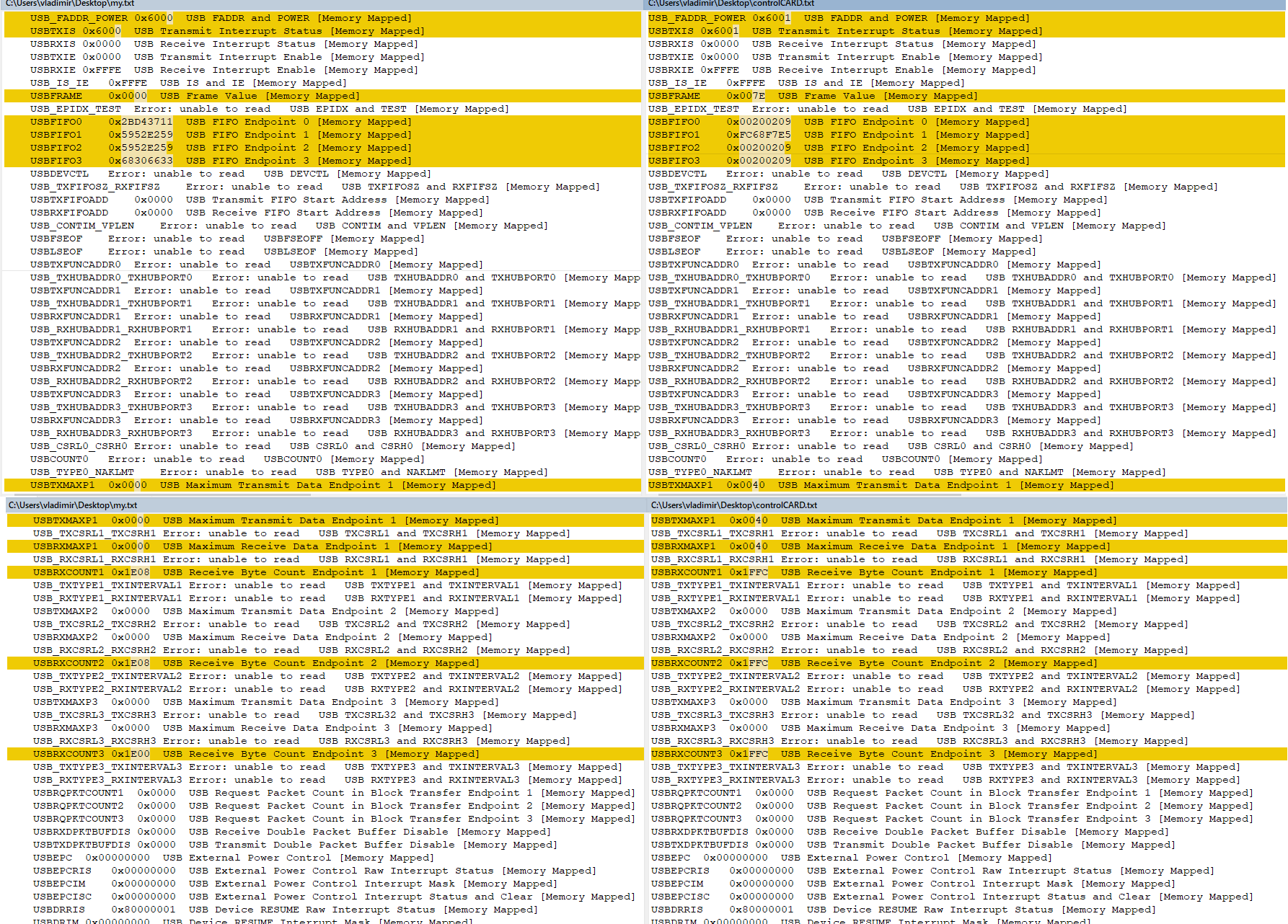

    The peripheral USB registers that I was able to read after starting both options are different as shown in the screenshot.(left - my board, on right - controlCARD)
    Again, I didn’t make any changes in the code compared to the original, except led blink for control that cpu is work. When I change boards I just change define LED1 LED2. Thats is all differences in code. Then I switch targetConfig from XDS100v2 for controlCARD to XDS110 for my board and load to flash.

  • Vladimir,
    Thanks for posting that information.  I don't see anything in the register configuration that has any problems.  Can I ask how you created this new project?  I am not an expert on COFF vs. EABI, but if you simply copy a C2000ware project and modify it I think both formats should work.
    It looks to me like we are not getting the first interrupt that sets the USB stack in motion.  Is it possible you have swapped the D+ and D- lines at the connector such that they are connected to the wrong pins on the C2000 device?  This would cause the behavior you're seeing.
