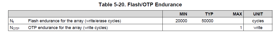

From the datasheet the max Flash Write/erase cycles is 20000 cycles.
May I know if over 20000 cycles, which kinds of failure will happen?

Hi Vamsi,
Could you advise the detail why it is for whole flash and why reduce the W/E on other sectors?
The datasheet is SPRS902A not preliminary one, customer need TI explain the detail reason why change this parameter from TYP 50K to Max 20K.

Chen,
We spoke to the DS spec team. Flash will work correctly for a minimum of 20k cycles, but may degrade if cycled more than 20k. Flash will typically continue to operate correctly for up to 50k cycles but any amount over 20k is not assured. The 20k spec was changed as MAX requirement to make sure the users interpret it accordingly.

HI Vamsi,
For "Flash will work correctly for a minimum of 20k cycles, but may degrade if cycled more than 20k", what the detail means of degrade?
Could you advise below answer detail ?
1. why 20K times, is not for each sector but for the whole flash.?
2. If a sector goes beyond 20K, it will reduce the W/E on other sectors?
Chen,
Degrade: Flash bits may not be able to retain the programmed data.
1 and 2. The limitation is not from flash bits/sectors themselves. Limitation comes from pump.
