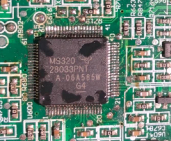

Hi Expert,
My customer meets an issue as below figure shown, that memory write failed when download/bootloader to OPT zone, and the address is origin = 0x3D7800, length = 0x000400.
By the way, the code could download to flash normally, the issue only occur to OTP on part of F28033 chips, around 500, in production line.
Could you please help to analyze which factors which could cause this issue, and how to debug it? Thanks!
The error information
The normal phenomenon
The device part number
Thanks!

  • Rayna,
    Was customer successful in programming the OTP of any device or it has failed in all devices? I am trying to understand if there are any issues related to the linker command file. Have they checked the .map file to ensure their section(s) correctly lie in the OTP range?
  • In F28033 device, USER OTP (0x3D7800 - 0x3D7BFF) is protected by CSM. If the device is secured, you can't program to USER OTP unless you unlock the device. Check whether the device is locked? If so, unlock the device and program USER OTP.
    Manoj
  • Hi Hareesh & Manoj,
    • This issue is from production line, and the otp.out file could download to most of device, as the below figure shown. The memory address is divided refer to datasheet.
    • The device is not locked, there's no password in CSM. For the code in flash could be download normally as below.
    What other information do you need about this issue? Thanks!

  • The fact that you are able to program the same .out file in other devices indicates that there is likely no issue with the .out file itself or the hardware. If you examine the contents of the OTP memory in CCS, what do you see? Could you send us the dump of OTP memory from a few failing devices?
  • Hi Hareesh,
    Do you need all the content of OTP? Could customer send you the .out file?
    By the way, why OTP memory content is different between different chips with the same .out file?
    Thanks!
    Best Regards
    Rayna
  • Do you need all the content of OTP?
    Yes. I would like to look at the OTP content of a few failing devices. Specifically, I would like to see if OTP content is similar across all failing devices.
    Yes. You could send this (and the above) via email privately.
    Is this the case across devices where CCS did not report any error while programming?
