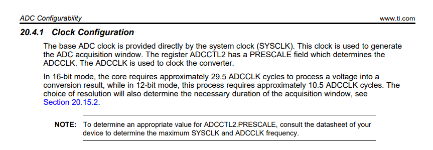

in previous f28335 clock source was HSPCLK what is the replacement of HSPCLK in F28388D.
what are all ADC clock sources in F28388D.

Hi Harshit,
Each ADC has an individual clock divider to derive ADCCLK from SYSCLK. You should set this to get as close to 50MHz as possible without going over.
The S+H is clocked from SYSCLK, so there is no jitter from when triggers arrive to when the S+H starts.
The ADCCLK does not begin clocking until the conversion phase starts, so there is no jitter between end of S+H and start of the ADC conversion and there is no power savings for using a slower ADCCLK.
