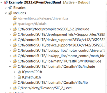

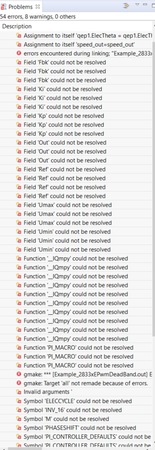

Hi There,
How are you? I am working on an in-house designed controller based on the TMS320F28335 DPS. I am using CCSV8, compiler 6.2.9, to compile the code. The code was tested and working. I have got a new laptop and had to reinstall the CCS, but the working code started giving me errors. Please see the errors and the code attached. Could anyone please suggest where the problem could be? Thank you very much!

    I am sure that the IQmath library path is correct, please see the picture below.

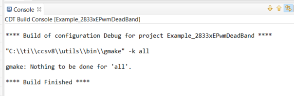

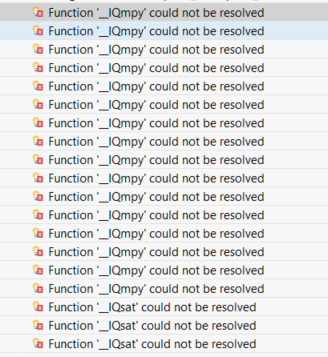

    The Code is able to build, but it seems like _IQmpy and _IQsat is not able to solve. Have you ever seen this kind of issue before?

  • This is the screen shot of the library path.
  • Hi Alex,
    I am wondering how the build is successful if it could not resolve some of the functions. Can you do a rebuild of the project and share the complete console output?

  • Hi Veena, please see the console output.

  • Hi Alex,
    So, is the error resolved? Are you able to use the _IQmpy function?
    Veena
  • Hi Veena,
    The project is able to build, but the errors are still there.
  • Hi Alex,
    I am unable to find these errors in the console output you shared.
    Veena
  • Hi Veena,
    Yes, you are right. This is the weird part. The errors are not shown in the console outputs, and the code is able to finish compiling. But I still get those errors in the Description.
  • Hi Alex,
    It could be a glitch in the CCS workspace. Can you restart the workspace or import  the project in a different workspace?
    Veena
  • Hi Veena,
    Thank you for the suggestions, but I have tried those already. I even reinstalled CCS twice, but this problem just won't go away.
    Alex
    I suspect you are getting CODAN errors instead of actual build errors. Please see the below thread for more details:
    https://e2e.ti.com/support/tools/ccs/f/81/p/944045/3487436
    ki
    Use this direct link instead:
    https://e2e.ti.com/support/tools/ccs/f/81/p/944045/3487430#3487430
  • Hi Ki,
    So if the semantic errors occur next time, I can just ignore it, correct?  Thank you so much for your help!
    Alex
